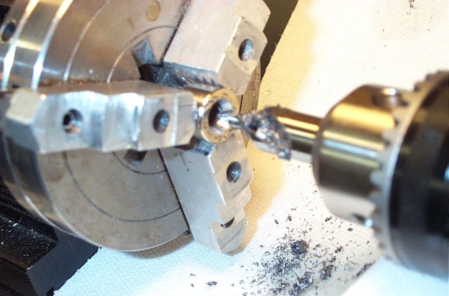

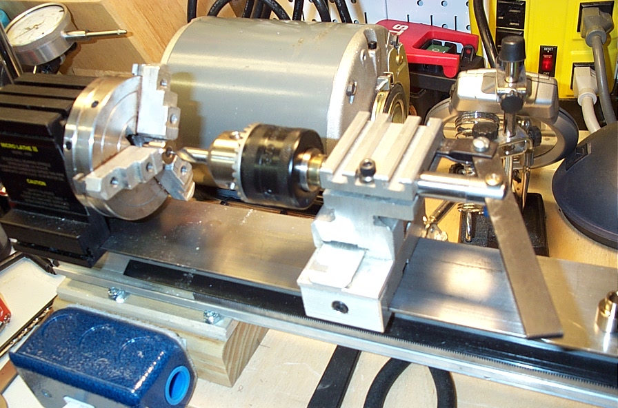

I am new to penturning and do all my turning between centers. Rick Herrel taught me a trick to adapt standard bushings to TBC bushings by adding the 60 degree chamfer. I used my Taig lathe for this but one could use any lathe for it with the right drill chuck. What is needed is a center drill and countersink bit (#4 or #5) to add a 60 degree chamfer to the large end of the bushing. See photos for details. Remember to use cutting oil.
My photos got reversed in order but you get the idea. :-) I used a #5 drill and did not go deeper than 2/3 of the face of the bit.
That idea is one I have used many times, although it just isn't the same thing, especially if the middle bushing which should be a 2 part bushing is a single part.
I agree that altered mandrel bushings are not as nice or solid as those made for BCT work. I only convert mandrel bushings because I do not use or even own a mandrel. I am new at this so theoretically a "middle" bushing that is large enough would need to be cut in two then each side of the cut faced to square it off and then drilled with the 60 degree chamfer to convert each side to BCT.
This is best done on a metal lathe but could be done (again hypothetically) on a good wood lathe by carefully cutting the center bushing (using a hacksaw as a parting tool at a very slow speed) then facing each rough surface flat (with a file) so when the chamfer is added the part will turn true.
I have a supply of PSI delrin bushing blanks that I plan to use for making BCT bushings when I cannot find precision bushings in the size I need. These delrin blanks are designed for shaping on a wood lathe with wood tools. I will do it with my Taig.
