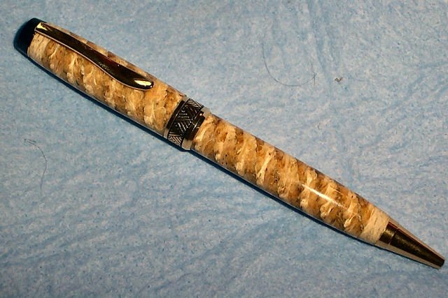

I've gotta think that the tartans are available in small enough designs that the actual material could be used. The woven appearance would greatly enhance the "real" appearance. And heck, if Eagle can make a pen out of denim or sisal, this should be quite doable!
BTW, here's one of Eagle's newest...Sisal!
