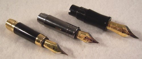

I'm wanting to tap some acrylic blanks to hold some nibs, has anyone found the correct taps to use with these nibs?
From left to right they are the replacement nib and the standard nib sold with the junior size pen kits, both from Craft Supply then the El Grande nib.
It appears that the El Grande nib may be a metric size 10-1 but I haven't found a tap yet to verify the size.
Visiting several specialty tool supply houses in town didn't shed any light and I'm trying to get some answers from a few online tap and die stores but could use any help from those who might have already been down this road.
Get a pitch gage to check the thread spacing and then measure the diameter with a pair of calipers or a micrometer.
That should give you everyting you need to purchase a tap.

I wish it were that simple but it's not... as far as I can tell!
Measuring the major diameter of the threads on the Craft Supply nib holder reveals .328" or 8.3mm.
After spending the past few hours pouring over dozens of thread charts, I've come to the conclusion that these threads are neither standard ANSI or metric threads since the closest ANSI diameters are:
5/16 = .312"
11/32 = .343"
And the closest metric threads are:
8mm = .315"
9mm = .354"
The closest thread size I found is a specialty Brass thread size of 5/16-26 which is close to the thread per inch count but a bit to narrow.
After seeing several folks making custom pens on the forum and obviously tapping their own blanks for these nibs, this must be one of those "held close to the vest" secrets that is not easily shared! :(
I'm still sticking to my first post. Once you know the pitch and the major dia., you can track it down. Also, is it a single thread?
Get me the info and I'll see what I can do.

Why not take the nibs to a hardware that carries loose metric nuts. Try them until you get the right size and then you should know what tap size you need. If this idea works a PM with the information would be really nice. :D
Mike
I don't have any of the junior kits or el grande right now. But the threads on an emperor are 10mm x .75. I think that the juniors are the same, but maybe someone else could confirm that.

I agree that the El Grande is an M10 X 1. That is the only one of the three that I have in stock. If you can wait I will check on Monday at work and let you know after tapping and testing it to confirm that an M10 X 1 will work.
