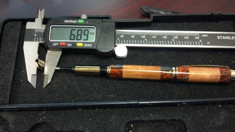

Any idea on the size threads used in the nosecone of Jr. Gent Roller balls?
I don't know if what I have is JG I or JG II. It is a JG though (I Think) and I'd like to turn a new section, I really don't like the metal feel, I have some hard Urethane (Think Alumilite) that would work great.
It could be m8.4 x 1 measure it with digital calipers and let us know what it measures.
It appears to be much smaler than that.
Nose cone threads measure 6.89mm and the thread is very fine.
Section end opposite nose cone where it connect to the barrel = 7.99mm
Cap thread measures 9.44mm
All measurements are outside diameter of thread
Note: this pen is from my Pine PITH partner tbroye and is a real pleasure to use as my daily writer at work.
I am guessing with out a thread gauge but 7mm x.5, 8mmx.75, and 10 x.75 the only real way you can tell is with a metric thread gauge. the plastic threads at 9.44 could even be 9.5mm x .75 or .8 Hopefully someone else willhave the kit and a thread gauge and tell us.
If the cap to body threads are plastic it is a Jr Gent I.
If it is a Jr Gent I, the specs of the threads between the front section and the body are M7.8x0.8. This is directly from the manufacturer. Smitty may be able to tell you the other thread sizes.
I have some alternate taps I am going to give a try today to see if they work. I will let you know how they do.
