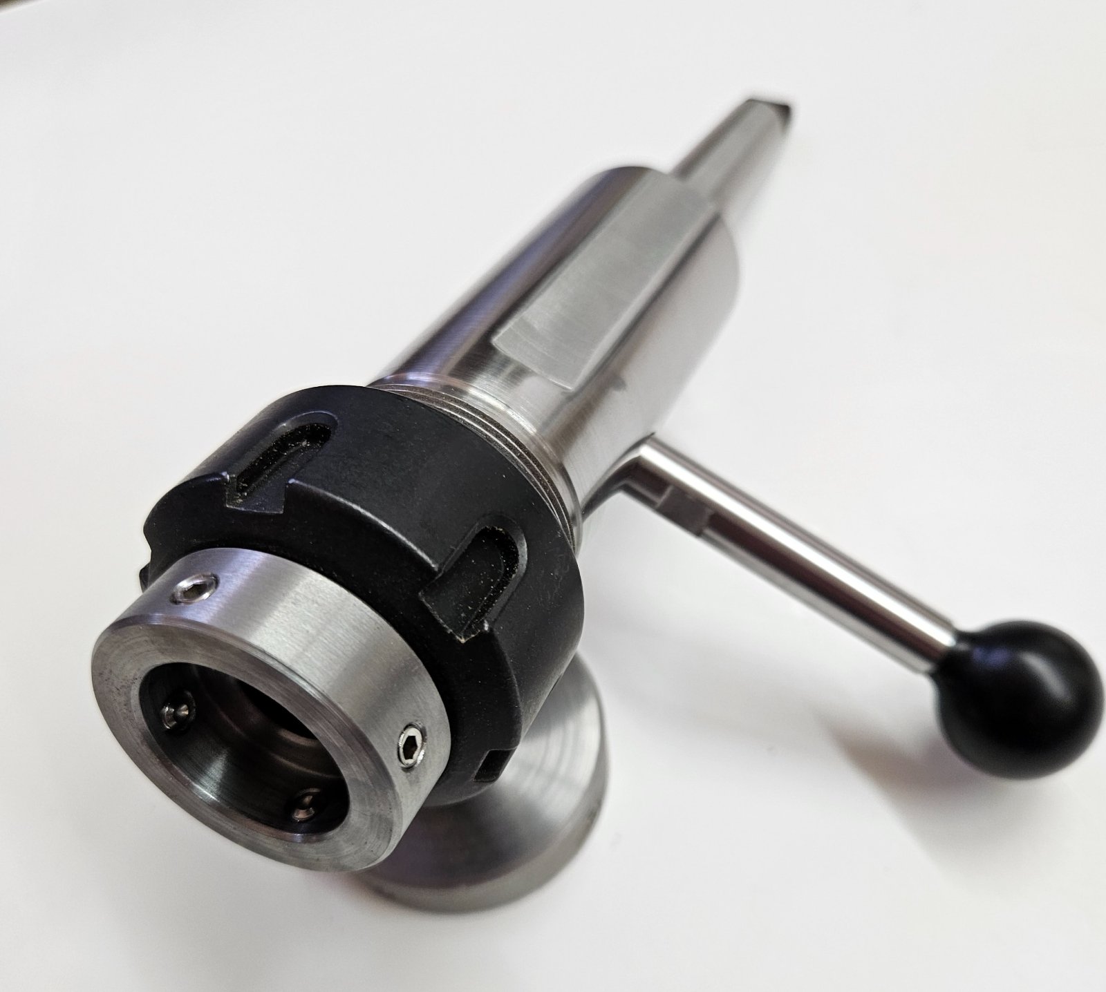

Rick Herrell has the best one.
Page 3 of his catalog:
You can PM him to order.
I owned the Neils-Niche and it was fine but rather pricey. Additional tap and die holders were expensive.

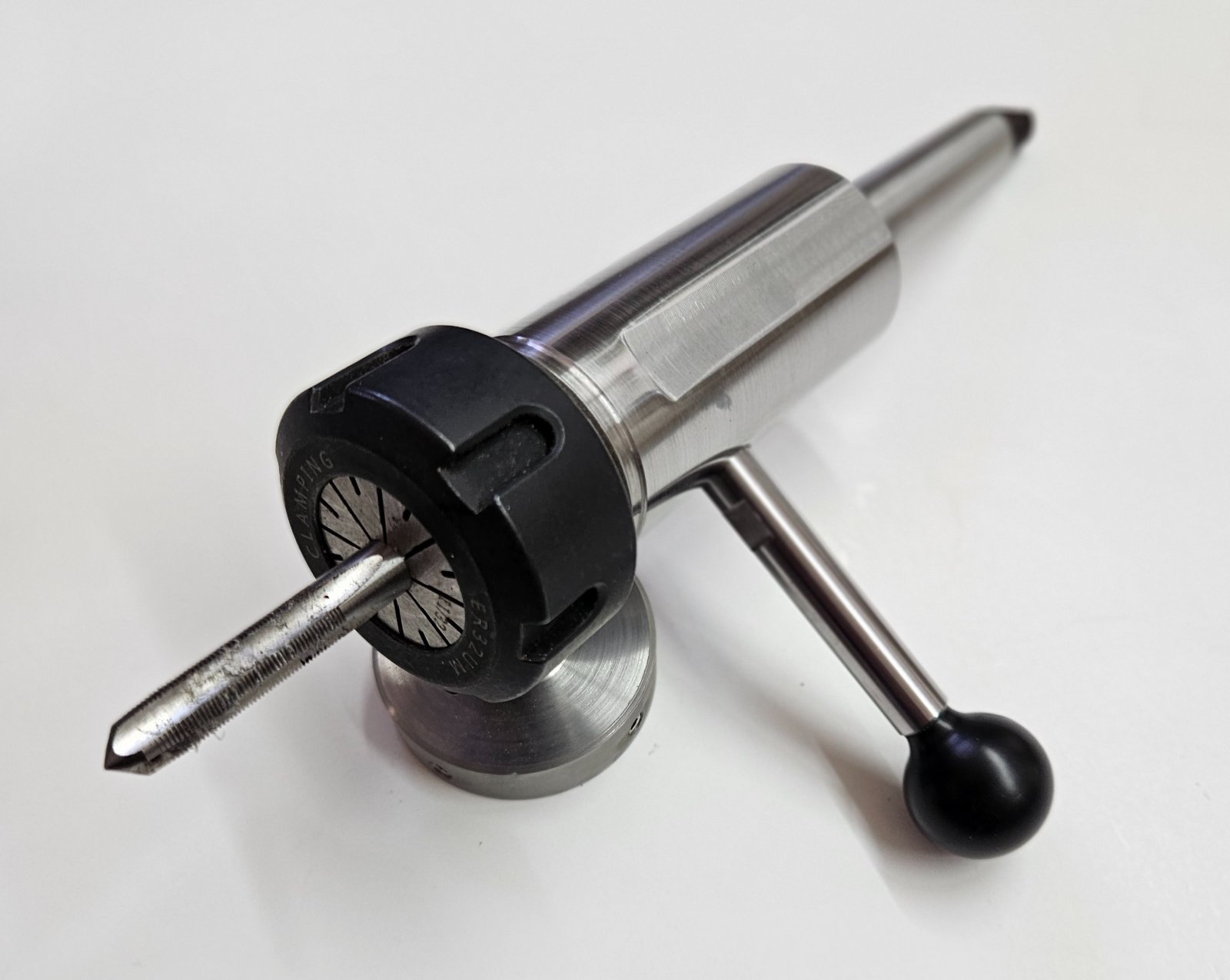

I have since sold it and have purchased Rick Herrell's (@rherrell) version that Mark (@hooked) mentioned above. Rick's design uses ER32 Collets to hold the die holders and taps. This, especially for the taps is so much better. AND Rick's additional die holders are very reasonably priced!

This is not a tool that you want to go cheap on. I am using this in my Jet Midi Wood Lathe, but will also be using it with my Precision Matthews metal lathe. It is that well made!!
Well my experience with Rick Herrell and his products so far has been 100% positive, so when I'm ready to bite the bullet, I think that's the way I'll go. Especially since I already have ER32 collets. Sounds like I should give the $60 Amazon ones a miss :D

I used the Niels-Nich for several years. Purchasing the one from Rick Harrell was a game changer for me. Taps and die holders are held with the appropriate ER32 collet...perfect alignment first time every time.
