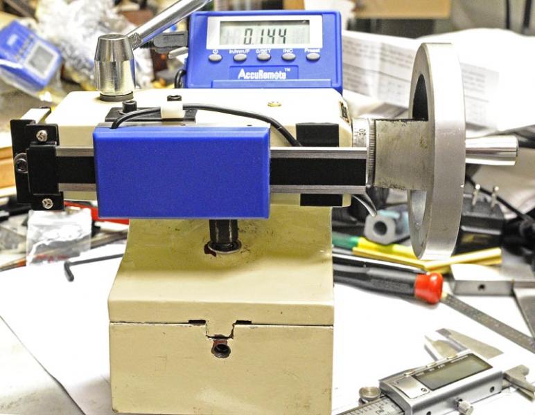

I liked Fred's idea of putting a caliper on the tailstock so today I'm taking an extra caliper and mounting it on my tailstock....
You know that's exactly what I was about to say before you posted this message. I really liked the installation I saw in BigShed's photo...I had to look back to see if his name was Fred. :)
So Fred did you make any drawings for those parts you made to install that caliper or did you just wing it? The only tricky part I see is how to make that plate match up with the caliper coming in from the side.
Basically I winged it:wink: I wanted the caliper at 45deg for easy reading, would have preferred it on either the top of the tailstock or at the rear.
On top wasn't possible because of the quill lock knob, at the rear the caliper fould the camlock lever, so front it was.
I then milled the bracket first out of some aluminium (aluminum to you guys:tongue:) and made up a plate to attach the caliper, I wanted to be able to remove it.
I originally had a much larger front mounting plate on the quill, but the angle was derived from attaching the caliper and marking it off.
I reduced the bulk of the quill plate as much as I could, then in use found that the slight rorational movement of the quill when drilling could at times affect the movement of the caliper. I then saw on a metal working forum (HSM I think) that someone used a ball link from a remote control helicopter to overcome this problem, once that was installed it was fine. It also allowed me to reduce the bulk of the quill plate even further.
As for fouling on my QCTP, that is still possible even with the reduced shape, but where this is a (rare) problem I just undo the little Allen screw on the rear of the quill plate and then the quill plate remains at the tailstock end.
Oh and as for my "sterile" shop:biggrin:, I might just go and take a current photo, the previous one was taken after I installed the DRO and had the whole lathe off the cabinet and a good chance to do a proper clean.
Just now it isn't quite so clean!:eek:

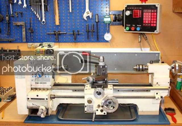

Can any of you post some pics of your setups?
and how you mounted the dros?
My pix are not as helpful as Fred's because he took the time to take them as he was machining. But here are a couple I did. The first one is mine. Then Chuck's 7x12 and last PTownsubbie's woodlathe tailstock.
I'm almost done with Chuck's 9x20 TS DRO but I really want him to paint the lathe blue before we do any more to it:biggrin:
