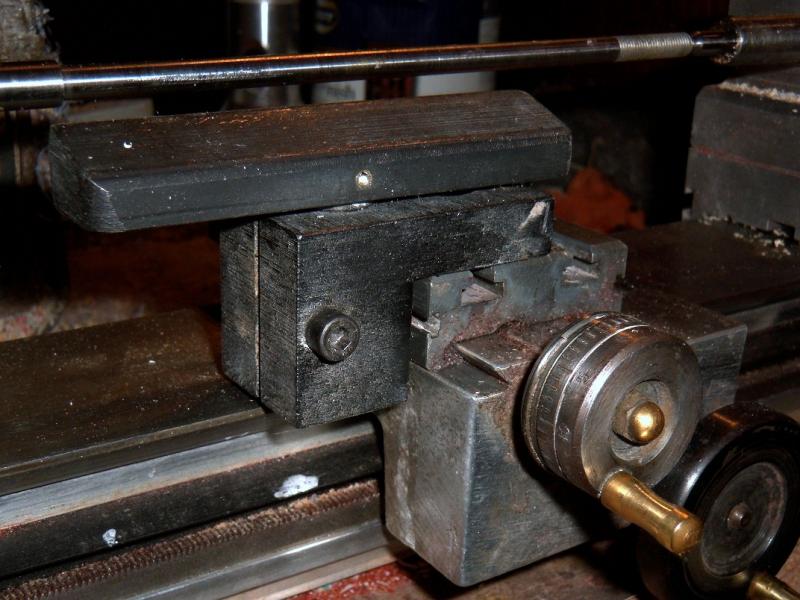

I use a 4" shop fox tool rest with a Taig tee nut assembly. It lets me rough in with the tool holder and carriage and then quickly switch to skew.

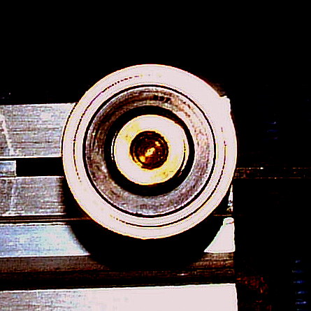

Morning I use my two Taig lathes for differing purposes however the length of a live centre can be diminished by making your own live centre setting a brass insert in the tail stock fitted with a bearing. Inside the bearing a brass insert with a 3/8 close fit to the mandrel as a mandrel saver. The Taig using their collets are ideal for working cartridges and drilling bullets.
The drive motor I use is a conventional open ended motor so I fit a thickish vertical shield that deflects metal and wood from entering the motor between the lathe bed and the motor this because the motor is mounted inboard to save space.
Unable to resurrect old pics of deflector couple of shots (small) of the tail stock mod.
Kind regards Peter.
