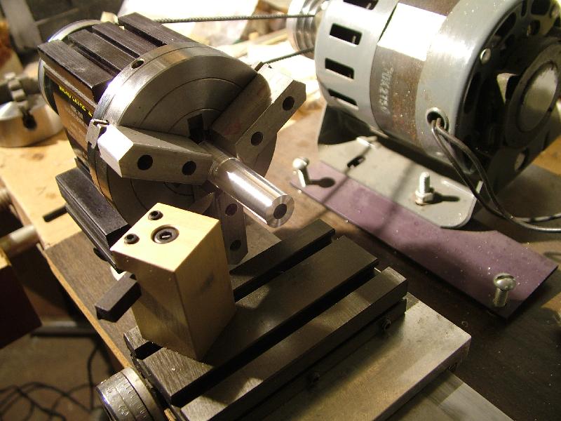

I got it set up ad tried out a small piece of aluminum. It works great but one
thing I've found so far is that the cut seems to be about 2/1000 lower than
center. Having no experience to speak of, I'm thinking I should shim the
cutters a bit.

thats normal, just pickup a cheap set of feeler gauges from the auto parts store and use whatever one sets your bit on center (I think I use a .020 on mine)
.002 below center isn't going to hurt any thing, .020 will be hard on your spindle, most printer paper is .003, a good easy check is chuck up a piece of round stock take a small 6 inch scale, with the spindle off put the scale against the stock, run your tool against the scale if it is pretty close to perpendicular,your good to go, if it leans away from you your cutter is too high of center, if it leans back toward you it's too low. If you cant tell, if it's leaning go ahead and cut, your pretty close to center,or at least within a TRCH, sorry this is a family site so I can't give an explanation for that acronym .

Problem with it being under center is that the cutoff tool doesn't cut OFF.
It leaves a very nice finish and a needle point in the center. And yeah.. it's
about a TRCH.
I chucked and re-chucked a piece of aluminum and wondered why it was
no longer centered. Then I put a boring tool in the holder and went inside
the chuck jaws to true them up. Worked great, but that's a bit scary.
Seems true now.

LOL ..
about a TRCH.
Seems true now.
I get a kick out of that tiny jacobs chuck though.. almost hard to take it
seriously when it's so small.
