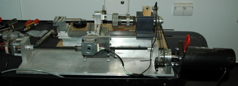

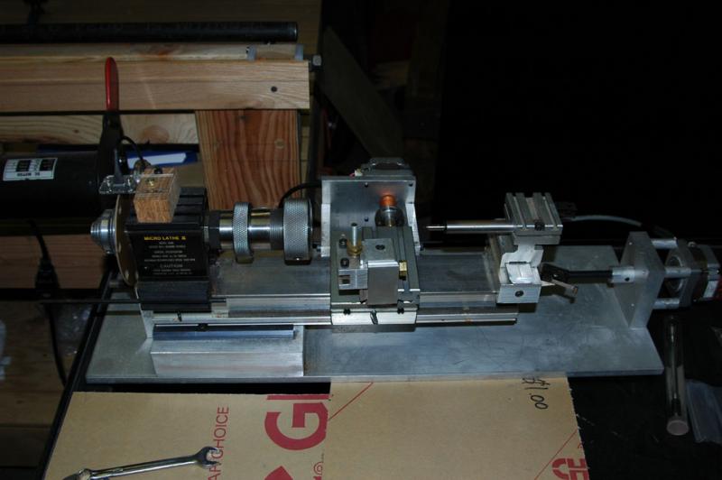

I CNC'd my Taig microlathe this past spring. The only modification to the lathe hardware was drilling three holes into the sides of the carriage for stepper mounting plates and lead screw attachment. Could send you some photos if you like.

Hi Joe, I'd like to see pics if you wouldn't mind sending them along...Happy Thanksgiving!

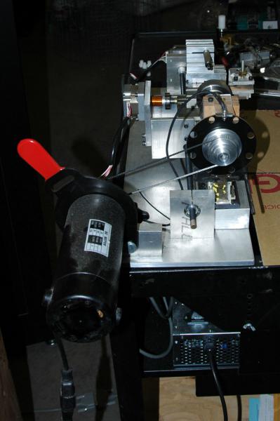

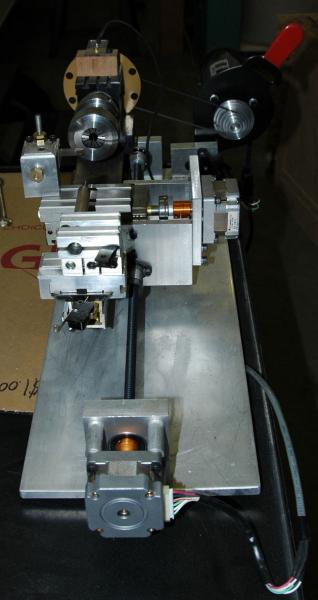

Hi Guys,
Since there were a couple requests for pictures here you go. This was my first DIY CNC project so be gentle. It is definitely overbuilt - 3/4" bearing blocks; 3/8" plate used for carriage flanges; 3/8" Kerke teflon lead screw - all definitely overkill butit works great. Started out with larger steppers too - something like 280 oz/in but they just looked too funny hanging on this assembly so dropped down to these little guys.
Mach3 for control.
Happy to answer questions.
Oh, I also have to agree - Nick Carter at cartertools.com is THE GUY to work with on anything Taig, IMHO.
All the best, Joe
