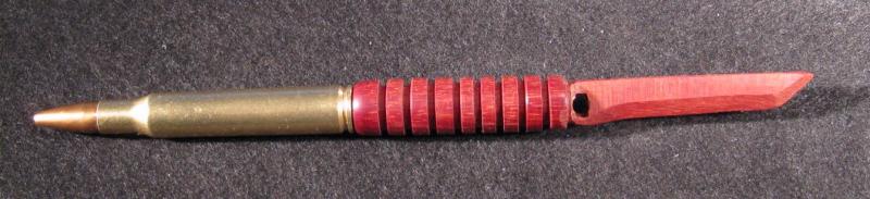

Ron, that one looks a little more functional than my version of a defense pen...LOL
