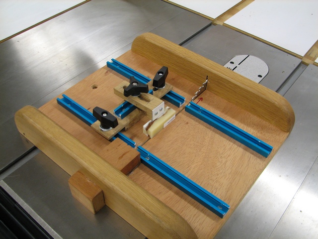

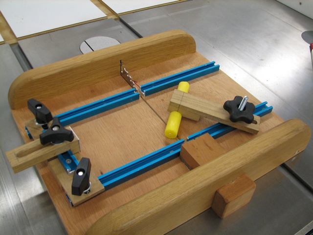

Here's one I designed. You can set it up to do just about anything.
attachment.php
attachment.php
I've made SEVERAL more jigs since these pictures were taken. The design is such that it's almost limitless in what you can do.:wink:
attachment.php
attachment.php
These t-tracks are alot cheaper at McMaster Carr than Rockler.
Now that is one beautiful sled. Why don't you submit it and a wright up on construction to some of the wood working mags?
Rick, how much would you charge me for one of those killer sleds?
I've been asked by several people and the problem is that not all table saws are the same. In order for ANY sled to work PROPERLY the runners on the bottom have to be an EXACT fit. That's impossible for me to do without having the saw to work from. If I make it and leave the runners off then I can't cut the kerf and square up the T-track.
PLEASE feel free to copy it, it's really not that hard to make.:biggrin::wink:

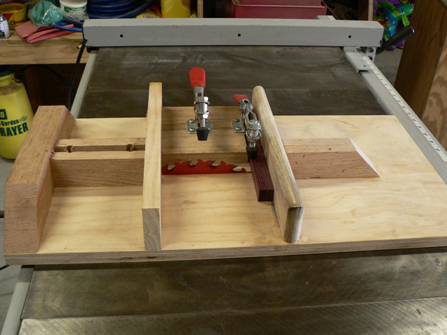

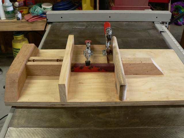

Here is a sled that I put together for blank ripping and cutting.
