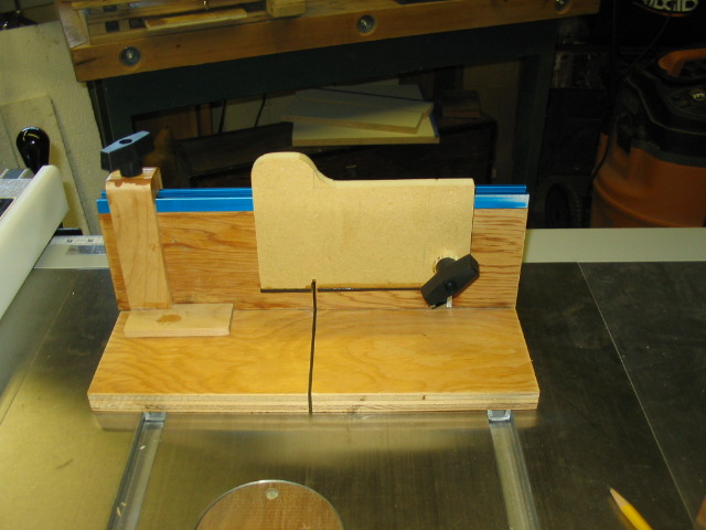

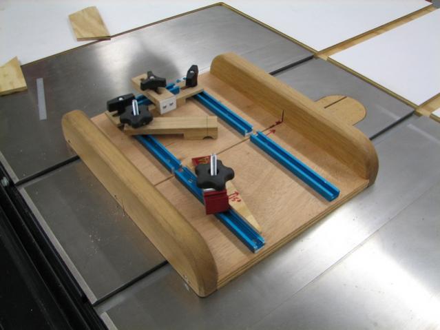

Not sure what you are looking for. One to just cut the length of a blank or on to cut angles in a blank. There is one to cut lengths in the library here I think. Here are the two I made. The first one is the one I think there is a tutorial in the IAP library, sued for cutting blank lengths or thin slices of wood. The second is used for cutting different angles and whatever in blanks. Rarely use either one anymore. There must be a thread on the second one also because it is fashioned like Rick's and I know I didn't dream it up by myself.
Yep after looking at the thread Rick directed you to I know that is exactly where I got the plans (idea) for the second one.
