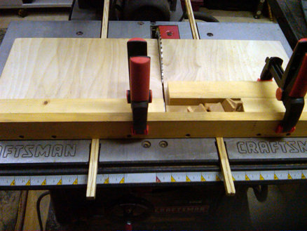

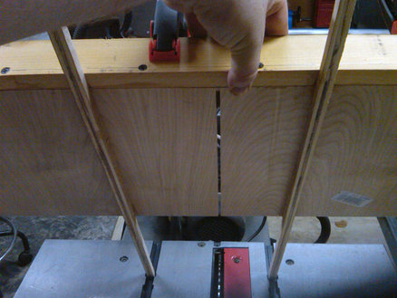

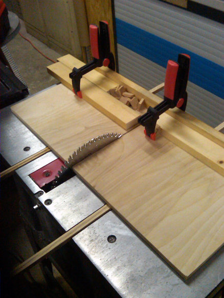

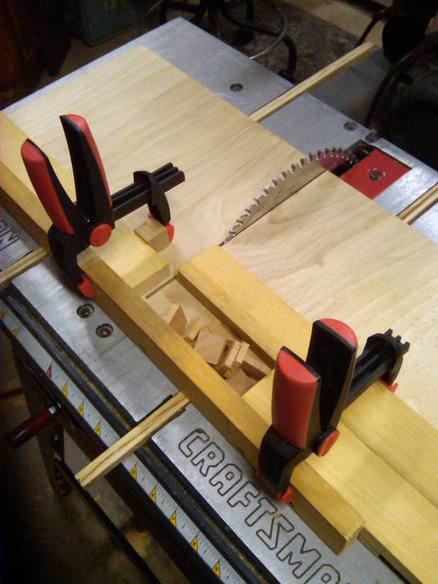

Segmenting Sled I used.
This is something I came up with for my 10" Craftsman Table Saw although I use my Bandsaw now with a little sled.
Not shown in the picture was a small triangle block I added later at the entrance of the catch pit to help deflect and push pieces into the holding area.

studioso said:
Larry, if I understand your jig, it seems that there is a dangerous situation where the cut piece is stuck between the blade and fence.
Not really most pieces are pushed past the stop block. I've only had a few that have been doing out. If anything few get thrust into the pit.
Flung out not doing out. I didn't check the auto word correction.
No, that's my full size TS. Sleds are almost impossible for the Byrnes because as it is it will only cut about 7/8". If you add a sled you can't even cut a 3/4" blank.
