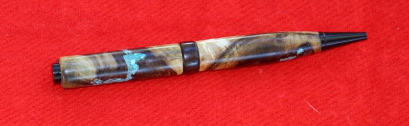

This was my first experiment with the SYP for a PITH pen. Southern yellow pine knot with turquoise infill.
Very Nice! I like the inlay, hope to find a inclusion that needs a bit of filling for my own PITH pen.
If it doesn't have an inclusion, make one! I use a dremel and a dental bit, but you could use any small bit. Find an interesting knot, enlarge any natural cracks, and route out grooves following the shape of the knot. This particular pen had lots of lovely holes, but I often help nature along to produce an interesting infill.
I had considered just that and it maybe the route I end up taking. I have a ton of root stock to cut yet and it sure would be nice to have it happen naturally. Frankly I have been stuck in Brain storming mode since the first images of other PITH pens started to show up...... I have about 4 pens going in 3 diferent styles and I am thinking of scraping them for a 5 idea thats been tugging at the back of my mind.............:biggrin:
Actually, on this particular pen the knot came flying completely out and I had to chase it down and glue it back in and infill around it.

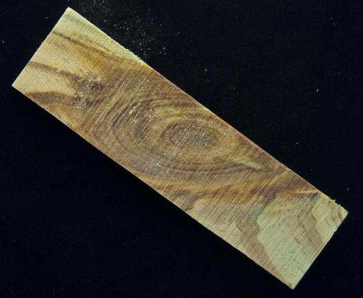

Sharon, Thanks so much for the offer..but I found some wood. My son pointed out all the pieces that were left over from the pergola that he built.
I found a piece with a large knot and made the PITH Pen out of it this A.M. Turning a very large knot in wood was interesting:eek:. Thanks again, Doc

OOOOO...that's a LOVELY knot!

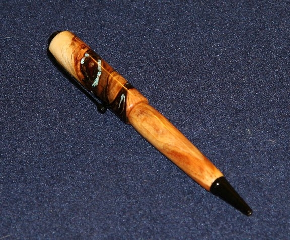

I like the looks of it, I really like the way people modify a slimline pen to look such as this.
This one came out almost like a mini-cigar
