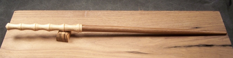

I had a request to make a custom wand for a person, based on the Harry Potter books/movies franchise.
Here is what I came up with based on her specs: (Sycamore handle, walnut shaft, 15" long)
Wand:
Close up of the handle:
I've done quite a few of these in the past, for Harry Potter fans, lots of fun.

Originally posted by shawn394
Do you use a dowel to join the two woods or just glue. I have made a couple but just out of one wood. They are fun to make. Thanks
Yes, I use a thin dowel that is the size of my bottle stopper mandrel.
Originally posted by ahoiberg
that's a nice looking wand. do you just turn between centers or use a collet chuck or what?
I use a bottle stopper mandrel that I got from I think CSUSA. I drill the hole, thread it on, and apply light pressure with the tailstock. Then when I'm ready to turn the end and finish I pull it away from the tail stock and finish. I do the same thing for the shaft and handle.
I use some thin dowling that matches the size of the hole for the mandrel very snugly and a dab of CA and voila!
