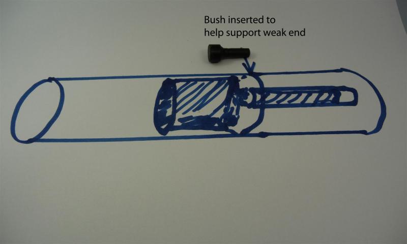

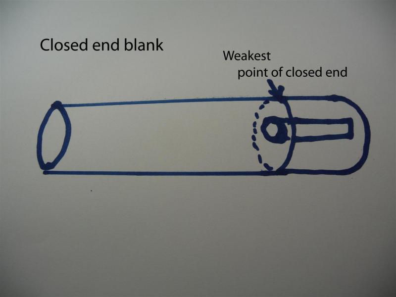

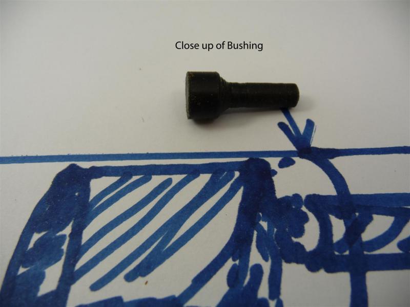

Because I had some breakages on the Barrel while turning closed ends, I made myself a SUPPORT BUSHING,
Picture 1 shows the Barrel drilled out, and the weakest point,
Picture 2 shows the Bushing inserted and helping support the end,
Picture 3 shows the actual bushing.
The big end of the bushing can only be a certain length because the closed end mandrel has to go in a certain amount to maintain contact at the open end.
I tried it and it helped tremendously. Maybe it has been shown before, so please excuse me if it has been and point me to it so I can learn!, thanks Amos:smile:

Lou, it was very trying when I used up one complete blank and ruined it, so necessity was the mother of invention! It has improved the success rate, I still support the work with the headstock also, but there comes a time when the headstock has to be moved away and then it proves very helpful- still, use plenty of gentleness and sharp tools. Amos:smile:
Wow, that is another really smart idea from the forums. I've had the occassional closed end break or collapse right at that exact point.
Hi Amos,
good idea in turning a 'bushing".
Q:
Can you use a 'machine' screw (rounded head) and cut the thread to the length required?
