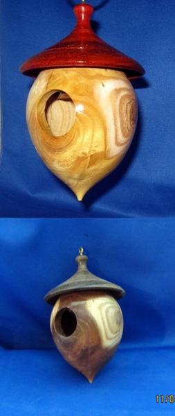

Very interesting thread. I just thought I'd show this. Talk about color change. This is a bird house I made and hung outside this spring. It is Mulberry bottom and bloodwood roof. I took it down yesterday to bting in for the winter. Quite a color change. And, it was sprayed with a UV inhibitor finish.
