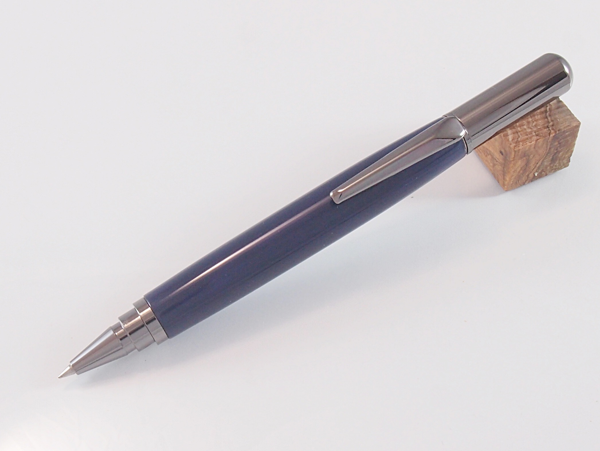

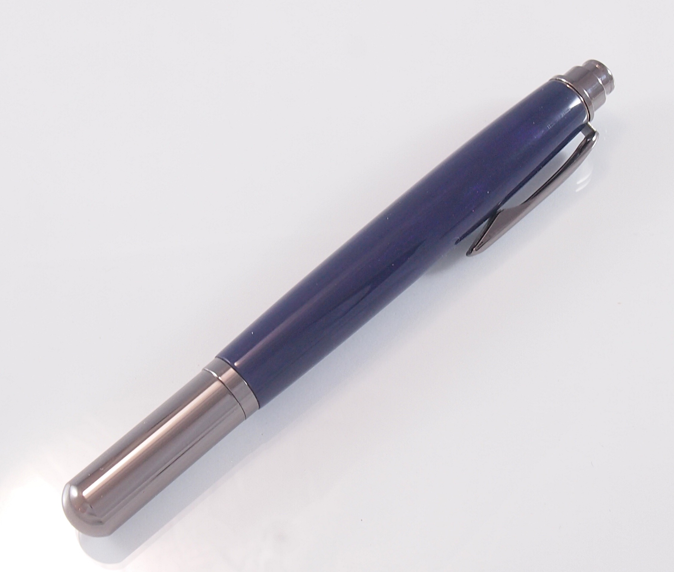

I was pouring some blanks this morning and had mixed a little more than I needed so I started looking for another pvc mold. I noticed a piece of pvc in a pile of stuff on a shelf and grabbed it. To my surprise it had a blank still in it so I knocked it out and found a deep blue blank. I do not remember pouring it. I decided to make a gun metal rollester with it.

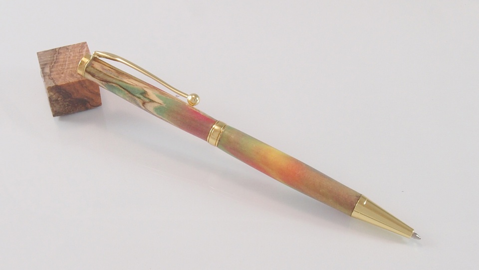

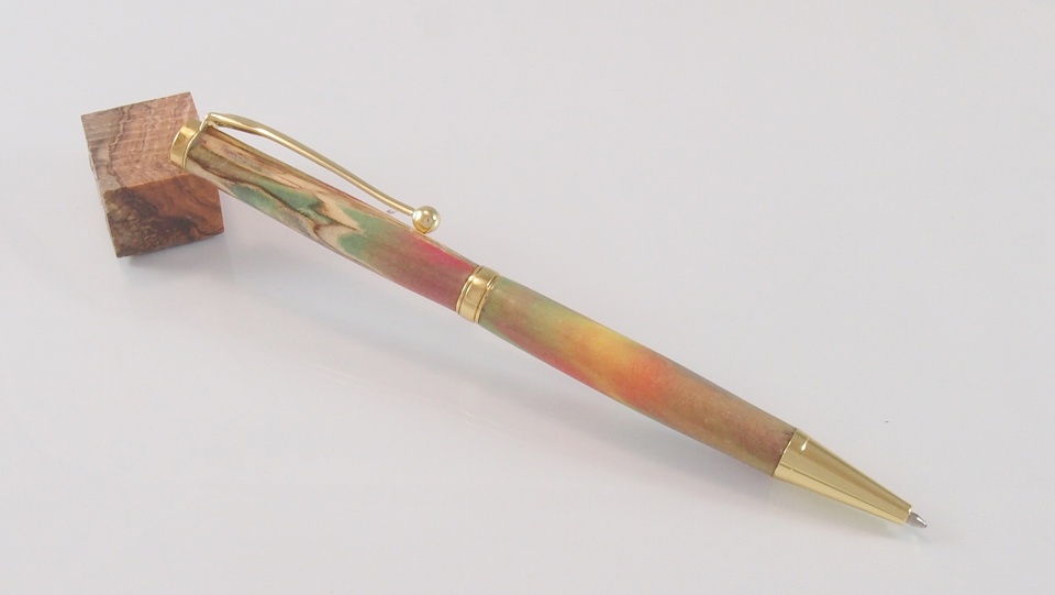

I then noticed a piece of multi colored wood that I had used to to experiment with dye and cactus juice. It was fairly ugly so I had never turned. I decided to turn it round to see what it looked like since I was feeling lucky. I liked the look so I made a slimline with it.
Not too bad for stuff that was just laying around.

Do you like the rollester kit? I've never made one. Yours looks awesome.
Rod
The rollester has a nice feel and writes nicely. I am not a fan of the appearance but a lot of female family members and acquaintences really like it.

Love the look of that slim line. How did you combind the CJ and dye?
I mixed a couple of drops of Douglas and Sturgess Dyes with the cactus juice in dropper bottles, covered each side of a punky piece of woof with drops (letting it soak in overnight before switching sides), pressurized, and then heated.
