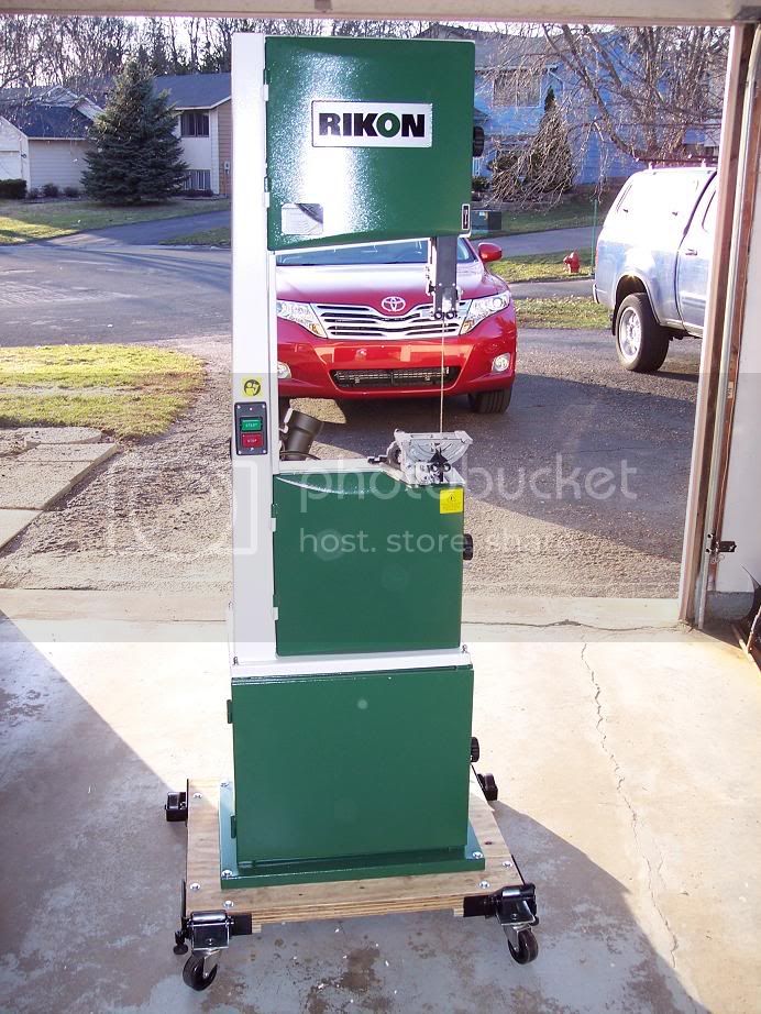

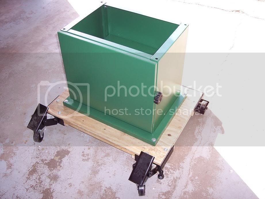

I got the stand and base put together for my new band saw (Rikon 14" Deluxe) and the universal stand from woodcraft. Very solid and heavy. I'm pretty happy with the how smoothly it rolls, and just need to get the upper half of the saw bolted on. The upper half comes pre assembled for the most part, so it shouldn't be too bad.

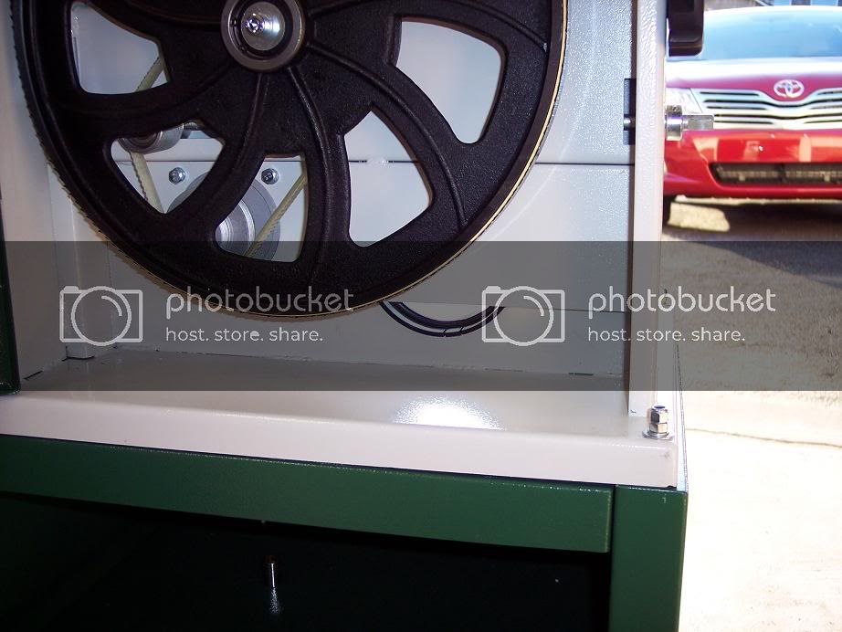

The only thing I really need to do is remove the safety plate in the back that partially blocks the 4" vacuum port. It's tack welded in a few spots and once thats gone it will be much better at removing the sawdust.

Did you guys remove that safety plate in front of the vac port? If so, did you do it without taking taking the lower wheel off? I hate to mess with that wheel if I don't have to.

I didn't take the plate off of the dust port on the inside. However, I did split the 4" flex hose with a 4"x4"x2.5" wye and ran the 2.5" hose up underneath the table. I find that is helps suck some of the dust right after the blade cuts the wood and prevents dust from blowing around.

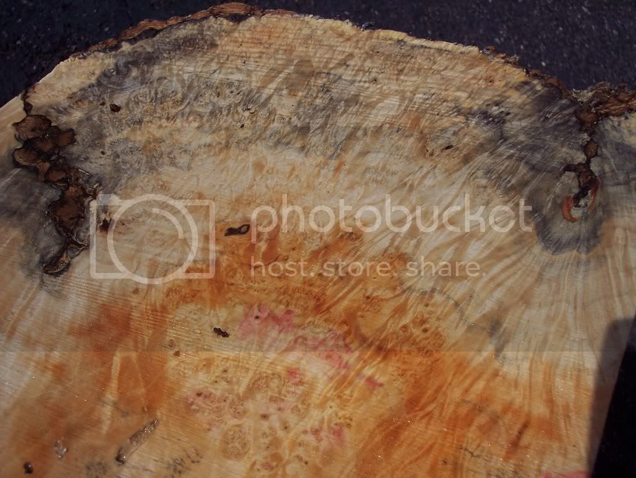

Oh and wanted to share with you a pic of some stuff I cut today. Had this stuff drying for a long time. Love cutting burl............. cuz you never know whats inside. :D
