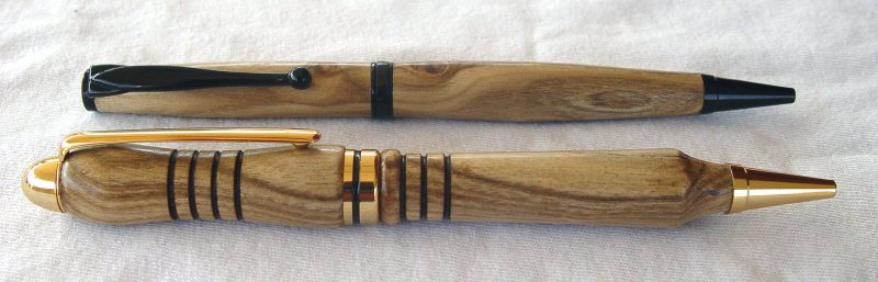

William, here are a couple of pens out of sumac. As I said before I screwed the one on bottom by using the wrong tip bushing. Bet I will never do that again. Sumac is pretty nice wood. I particularly like the little knots in the top one. I try to find trunks with those in it now. I have a few small trunks drying and they should be about ready, although these pens were done with pretty green wood and no cracks after several months.

Nice pens. I see what your talking about on the lower pen however I think that the fact that none of the metal pieces meeting wood on the same level makes it look like a design feature and not a mistake. I'd use it!

Sure is nice looking grain. For the cut in rings design on the bottom one , is that done just with a parting tool? and how do you make them black like that?

William, the black lines are wire burns. It is really a very simple addition. I like to cut a small groove with the point of a skew. Then burn the lines black. I ordered a set of three steel wires with large wooden balls attached to allow a good grip. Each wire is a different diameter. Turn the lathe on very fast and hold the wire in the cut groove. I have to wrap the wire around the pen as much as possible. You will see it start smoking and learn very quickly how much pressure to apply on the wire and how long to let it burn. It takes some pressure but different woods burn very differently. Very simple but a nice design trick. Any steel wire would do but they do get VERY HOT, so be careful.

I could practice with different guages on different scrap woods before trying it on a real pen. I could wrap the ends around the centre of 4" or 5" pieces of dowel at each end and twist up with pliers to make a handle to hold it with.

For burning I use what we used to call bailing wire. I cut a couple of pieces of 1" dowel to make handles.
