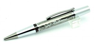

When I laser engrave pens I use rub n buff type paint on acrylic pens. I put a transfer tape mask over the pen and engrave through the mask and into the material then paint. I've used many different paints over the years, but generally just use black krylon spray paint on pens with just text.
Here is an example of the silver rub n buff on a pen I made from the M3 White mokume.
I hope this helps some.
