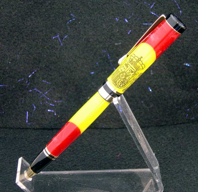

I did this customer a pen for his mother for Christmas and had it engraved by Kallenshaan. Now he wants cigar pens for his wedding party.
Osage orange for the yellow and bloodwood for red. I just got an order of Dymondwood and it would be great for your colors also. I would think any white wood will do.
