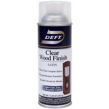

I have a lot of wood blanks that were purchased several years ago. In the past, after sanding to 1000 grit, I finished them with a friction sanding sealer and a friction polish, neither of which are currently available. Also in the past, especially for bandsaw boxes, I use a Deft brand aerosol water based sanding seal and Deft aerosol lacquer, again neither of which I am able to find. I've done CA finishes with good success, but in so doing lose the "feel" of a real wood pen, as the CA imparts the feel of plastic. Any suggestions for finishing these elegant woods?
Thanks in advance for your suggestions.
