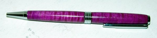

This is the pen. Tell me what you think. The finish is CA/BLO.
I am going to get some more curly maple and some more markers. Green is my next one.
Shane, That is nice. My daughter wants a purple pen. Think I will try some of that marker. Was it easy to use? Did it penatrate the wood very far? Thanks for sharing that with us.
Ben
I am not sure about penetration but I doubt very far. I turned the blank and sanded to 1200. I touched the broad tip to the wood while it was turning and slid back and forth a couple of times then buffed with a paper towel and pinched it like a friction polish to heat it up and evaporate any volatile chemicals. Then I just added my CA/BLO just like normal. Super easy. In the light this thing really shimmers. I had to beg my wife to let me take it and show it around. She has never been so pen-possessive.

Great Purple there, If the other colors work as well you may have a great answer to the "How to Get School Colors" Question.
Definanlty a winner if the color holds up. The purple just jumps at you and locks your eyes in. Very beautiful pen! The curly maple compliments the purple nicely.
Wow! Very nice. I am a purple lover as well and I would definitely buy this purple pen. Great job!! Great! Great! Love the colour!

It really is great looking. I will have to check my local art store for something. That site you listed has crazy shipping rates. Thanks for sharing.

Look's great and thanks for the tip. I have a customer that is after a purple pen. I have a piece of violet maple burl, but she wants alot of figure and I'm not sure that the burl is going to get it for her. This is definately on my to try list.
Richard
Shane (woodscavenger), thanks for the inspiration and the information on coloring the wood. I picked up four Prismacolor markers and used them on some curly maple and birdseye maple I had. I especially like the look of the birdseye.
<br />
When my adult daughter saw the display box with these <b>four</b> and the other natural wood pens, her attention went right to the colors.
