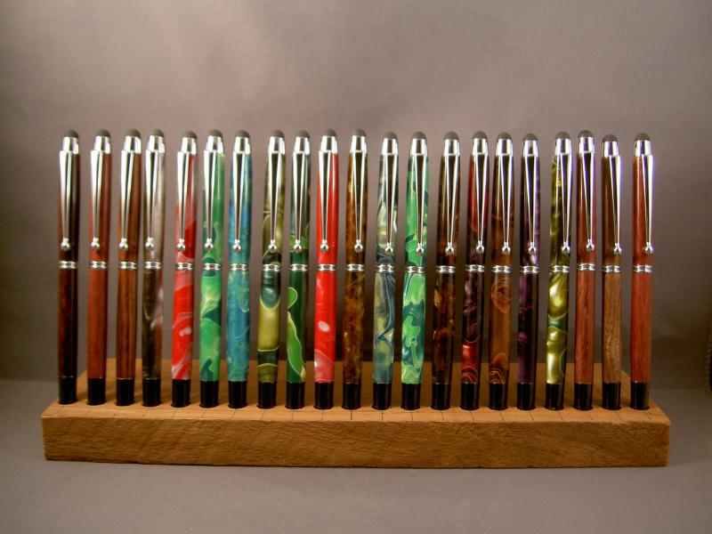

I just made 21 PSI pen/stylus and they look like a nice kit. They just got replacement rubber ends 3 for $5 and change which is nice to know.
