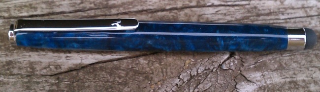

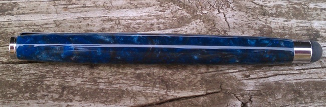

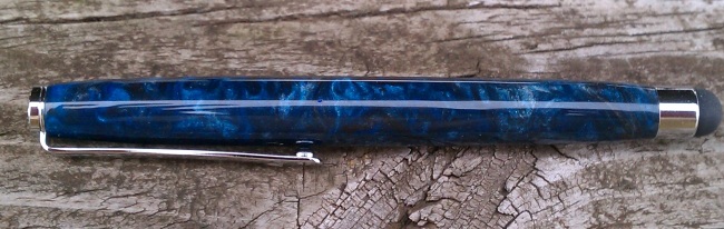

This is a PR blank my daughter and I cast together. I have had zero luck on blue blank casting. This time I used oil paint, pearl-ex blue, and some grey. I painted the tube colbalt blue and mixed the same paint in the epoxy. This is my first csusa stylus kit. I could have went a tad thinner in the middle section as you can see the clip slopes upward in the photo. Other than that I am very happy. More so with the blank lol. It does work though on my EVO 4G phone. I will probably get a stock of these together to carry. Thanks for looking and comments welcome.
