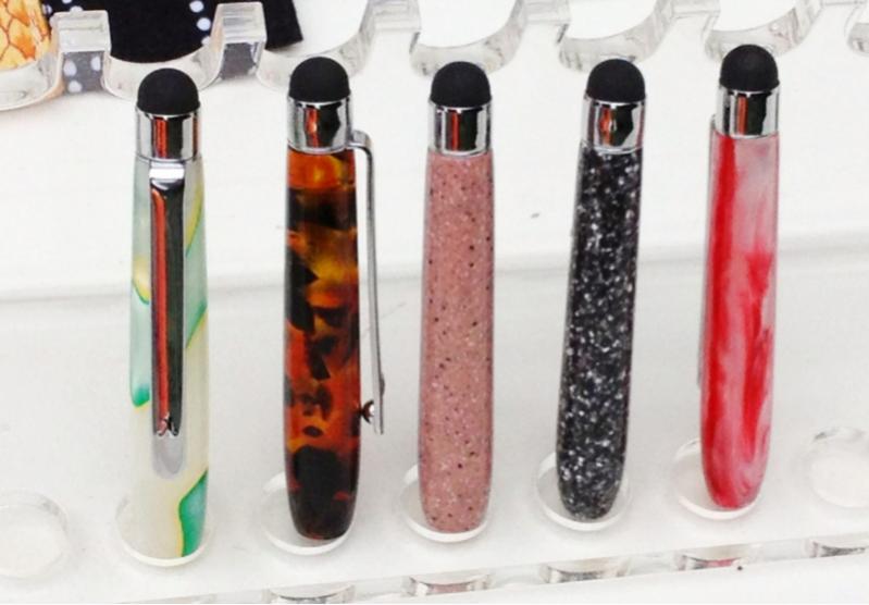

These are using some of the CSUSA components. No tubes.
Aside from the sorry photography, what do you guys think? All C and C welcome.

Those are pretty nice, i like the clip idea on a stubby.
Thanks. Without the tubes, the clip is mandatory. Your fingers need to touch metal on these, which is hard not to do with such a small package.

Dropping the tubes allows the acrylic to really stand out. Very creative idea.
Yeah. It allows the blank to be what it is as opposed to whatever color it's painted. The light being able to pass through most of them is really cool. One of the reasons I've always love componentless tortoise shell pens.

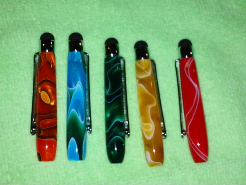

They look great. I'm not surprised that they are popular for you. I made a bunch of the "bobble" styli for a show and sold them all.
Since your not using a tube with these I'm curious....are you just drilling one the end just enough to press the stylus tip into the blank? If so how are you holding the blank to turn it?
Thanks. I only drill one end, and leave about a 1/2"? on the other end. To turn, I just push them onto one of the HF punches, herald in a collet chuck. The punch fits so well, I have to twist as I press, or it traps the air. With that, I just use the tail stock and light cuts.
