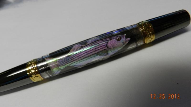

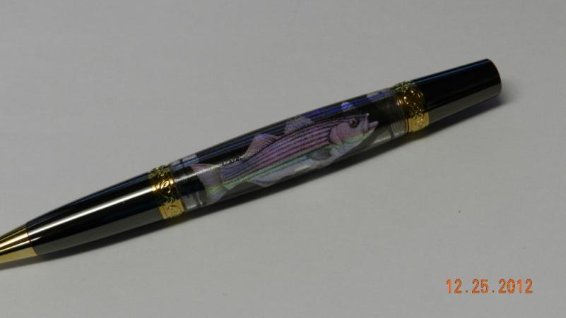

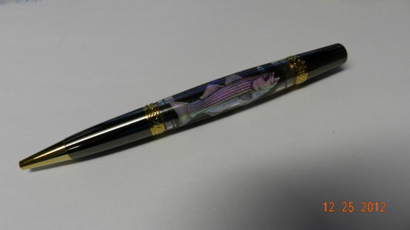

Haven't posted in a while, but have kept trying new techniques. This one is almost ready, just need to tweeked a bit more.................
very nice......the fishing men will be asking for more. Personally, i would want a northern pike or muskie.
Like ALA asked.......What would you do to make it better?
Can you be a little more specific as to what you did??? Is this painted, decal or something else??? No details there. It does look good. I wish the photos were abit brighter to really catch the colors. Thanks for showing.
I used a holographic decal on a black nickel tube. I tried to keep bubbles in the aluminite to simulate underwater, by not pressurizing, just air curing in the mold. I noticed I'm getting, what looks like a slight delamination in various areas. The tubes were washed with alcohol, fine steel wooled and washed again. I think the next batch I'll put in the pressure pot. I did use Aluminite water clear to do the casting.
