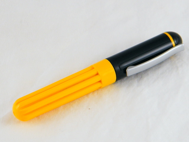

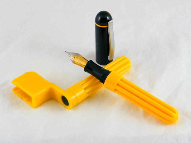

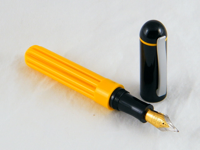

Finally got this finished up Sunday. I've been playing with this idea for the last few weeks and had been stuck on how to incorporate a cap for this pen barrel. For those that don't know, the original tool (in the fourth pic) is a guitar string-winder. It's used to quickly wind up the strings on tuning posts so you don't kill your wrist when changing strings. I have several of these laying around the house, and thought it would make a very cool and original pen.

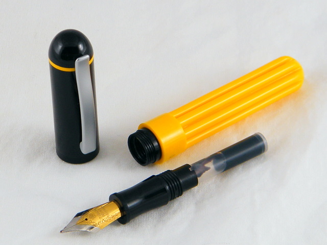

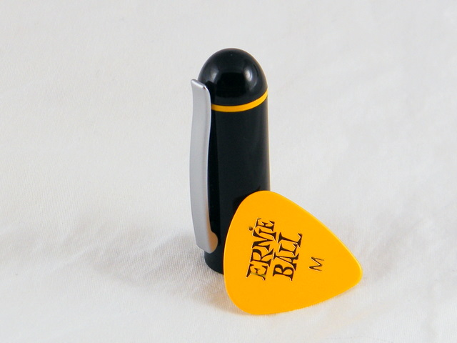

It takes a short fountain pen cartridge. It's not long enough to take a converter. The cap is just black acrylic segmented with two medium guitar picks. I used parts from an old Churchill pen that I had scrapped. I pushed out the threaded piece from the nip coupler and made a custom ring to slide over it to allow the threaded cap piece fit flush with the lower barrel. The new nib coupler is glued into the body. I omitted the trim ring from the cap. The recessed clip is from an Elegant Beauty Sierra and was a last minute addition to the pen.
Hope you folks enjoy it as much as I enjoyed making it. Comments, please!

Nice one - if you want to use a converter, there are a couple of vendors here that sell a mini version - about the same length as a cartridge.

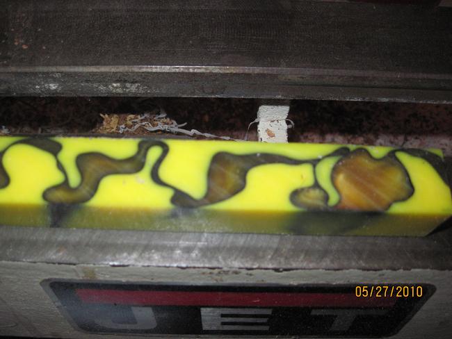

If you are interested, I have a Yellow and black storebought blank that is yellow with black ribbons going through it. If you want it to made a redux, I think a yellow pick sandwiched by two black picks on top with this blank would make an INSANE LID! The segmented picks would look like layered pickguard or something!!! I will ship it to ya for free just to get to see the finished product posted on the boards!
If you want, I will take a pic of the blank.
I just went and looked at the blank. It is actually made kinda neat... There is a layer of yellow, then a thin layer of black, then a neat gold pearl color, then black, then yellow again. The wild part is that is is very uneven layers. The stuff is all over the place. Pretty cool looking blank.
