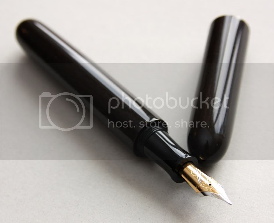

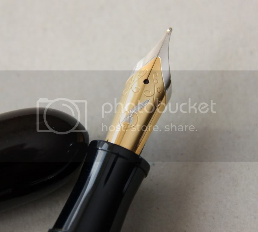

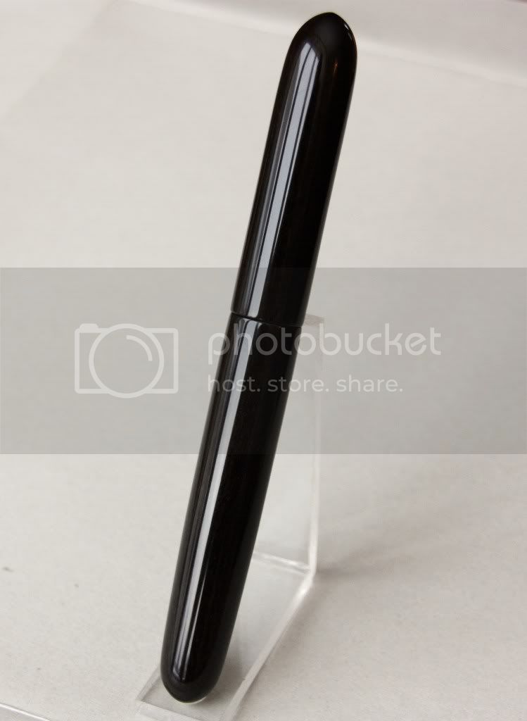

Hi all. Here's today's custom order, an ebony clipless FP in 10 coats of cyanoacrylate with a high polish. One of the pix shows it fitted with the optional Heritance nib. It is 153mm uncapped, 131mm capped, and 16mm diamteter (sorry for the metric, but what can I say - I'm Canadian, eh?).
Thanks for looking.

That is a VERY nice pen. So shinny! I tell you what though, my perverse mind when I saw the 2nd photo, well I can't say on here what I thought it looked like. hehe
Nicely done kit-less pen though. The quality of work shows through.

Beautiful! Reminds me of a Fischer Space Pen in general design, but this is done MUCH better and MUCH more beautiful, IMHO.

One thing I am doing very differently with my pens recently is to write-test, adjust, smooth, and tune every nib so that no buyer gets one of those 'disappointing nibs' that all of us FP afficionados know so well. The down side of this for me is that I have discovered that quite a few more stock kit nibs than I thought are pretty poor :frown:. Somewhere between one in four to one in three are not all that useable (I am rather picky).
Anyhow, thanks everyone for the kind words, and the motivation to make another of these!
Ken
I agree, testing, adjustment, and quality assurance are in indespensable part of making fountain pens. Nothing will turn a potential return customer into a detractor faster than getting that beautiful new fp home, inking it up and finding out it won't write, or writes poorly.
My findings are pretty close to yours on overall factory fp sections, BUT I have found that by mixing and matching nibs, feeds, sections, and converters between at least 4 or 5 kits (or that many spare sections) at a time, I can bring that incidence of a "unuseable" component down to less than 1 in 10. With a little more time and a little money invested in getting the experience and tools to properly floss, adjust and modify the nibs, it's down to about 5 percent.
But no matter how you do it, NEVER sell a pen that you don't KNOW writes well. Personally the last thing I write with a fp after I finally have it the way I want it, is the description of the pen, materials, ect on the back of a business card. Then the pen gets disassembled, cleaned and reassembled, and the card goes into the case with it.
