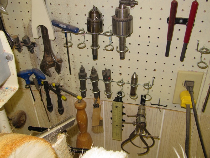

Here's a pic of how I store them!

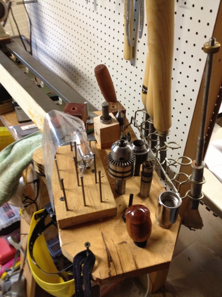

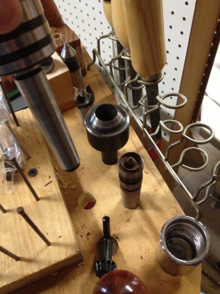

I saw a storage system like this but made of metal in one of the supplier mags. Just used some items lying around to make it so not that pretty but serves me well. Using the peg board tool holder accessory attached to it is great. I have a few things on the peg board you can see in the background but don't like to put anything directly behind my work for safety.
