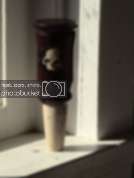

So I have been getting into turning some stoppers. Well I like to make things differently or add a darker side to them. Here is a Bubinga turned stopper with a skull embedded in PR on the top.
How's it look?.
Thanks for looking !
Ray K.
Gothyc Designs
Man, from that first picture I would have sworn that was black palm not Bubinga, what with all those dots as end-grain.
Either way, that is one cool stopper. Looks like it should be plugging a dark-genie's bottle. [}:)] [:D]
GK

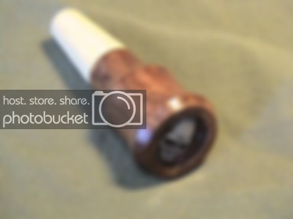

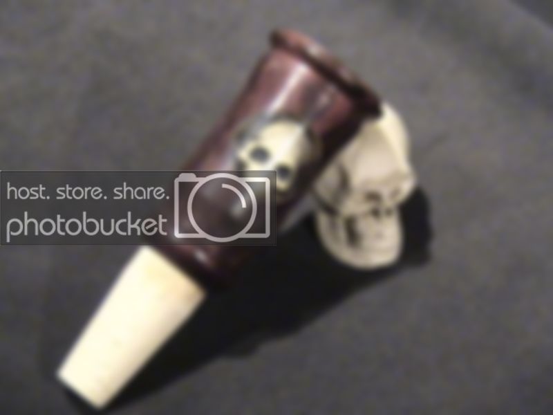

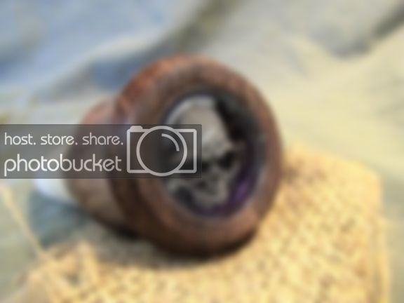

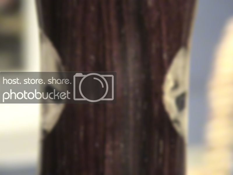

Well I'm back at it again and finished another one, this one is mainly a prototype, just because I have to figure the best way to embed the 2 skulls this time. The wood used is "Boise de Rose". As looking on the closeups, you'll see some gaps. I tried to fill in, but since the skulls were casted in the holes, the PR shrunk. Next time I'm just gonna have to use, I guess, 1" PVC as a mold and then drill to final dimensions after full cure.
Hope ya like....
Thanks for looking.
Later,
Ray K
GD
Ray,
You can try to fill the gaps by either method....
1. Fill with thin CA glue or
2. Re-pour some PR in them and let them cook again.
Great idea and wonderful execution
Ed Jordan
Wichita Falls, TX
Currently I only have the thick CA, but no accelarator either. So I have tried filling them a little at a time like a buildup process. But I go to turn and it flew out somewhat. I need to get some other CA like thin and medium. I did think about pouring some more PR, but was a little leary on messing things up. I guess it'll turn out.
The skulls I found a few years ago at a party store. They were a key chain. I made some slight alteratins to them and re-casted them to my own use on other things I was making before I got into turning. Not sure if they still available.
Thanks for the positive feedback, I'm gonna look into the gap filling more. I'm actually gonna cast them outside of the blank and then drill to size I need, hopefully that'll eliminate the gaps.
I'll try to get one made with the skulls sticking out a little and see what you guys think of that too.
