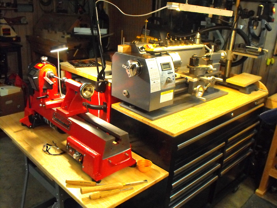

Willee
Jul 19, 2007
365
Corpus CHristi Texas
I find they complement each other.
I like to use the metal lathe to round square stock, drill holes, and make straight true barrel blanks.
Then they go on the wood lathe for shaping, sanding, finishing and polishing.
Here is a photo of my pen work station.
Do you just collect tools and keep them pristine? Otherwise, they are just way too clean. Really nice set up!
