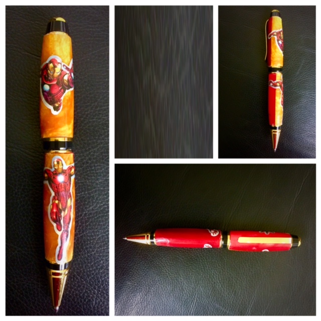

So initially the modge podge worked good....but when I went to sand it it peeled off in layers. I switched to clear acrylic and had much better results. Here's what I did!
Are you applying CA finish over the modge podge once it's dried? I did the modge podge on my stamp pens, let dry, then did 2 thin, 8 med. CA coats. I then wet sanded to 12,000 MM pads and polished with Hut's on my buffer. No peeling of finish at all.
I am now working on the Cowboys pen and using acrylic but the process is S L O W. Trying to build up the coats so you can't feel the sticker and the pen in smooth and even. I think next time I will make the pen and just cast it in PR.
CSR67, I will give it another shot maybe. I'll apply it and let it dry for 1-2 days and see what happens.
