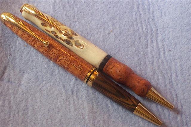

In the picture below the top pen is a "lowly slimline stock "kit"
It isn't necessarily the the fittings that make a pen that is "a bit nicer"[:D]
The Euro is just a slimline with a "hat and a belt"
