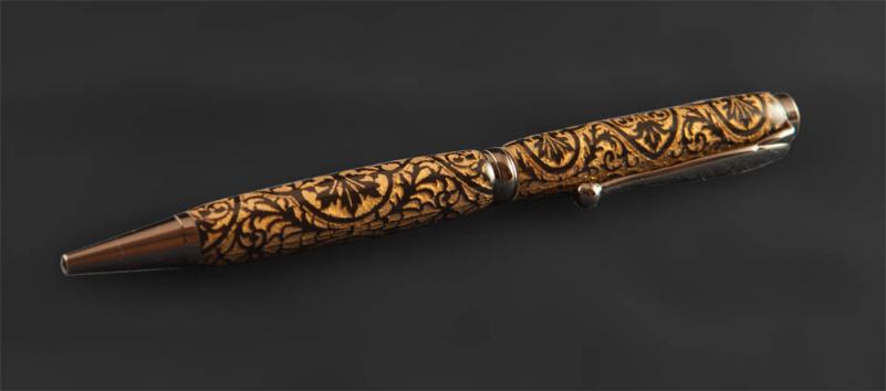

Another experiment as I continue down the carving path. This cast carved core pen was inspired by a Stencil pattern that I liked. Black PR core was carved. The carved areas were painted with gold paint. The carved painted core was cast in clear PR and turned to final shape. All comments and critiques are welcome. I like the pen, my wife didn't have much to say about it, which usually indicates something may be not quite right but she doesn't want to hurt my feelings. Brutal honesty greatly appreciated in any comments you care to offer here. You won't hurt my feelings.

That is stunning! Since you asked for it, the only thing I can see is the gold looks a bit rough in some of the larger areas. When I think gold, I think very smooth and shiny.

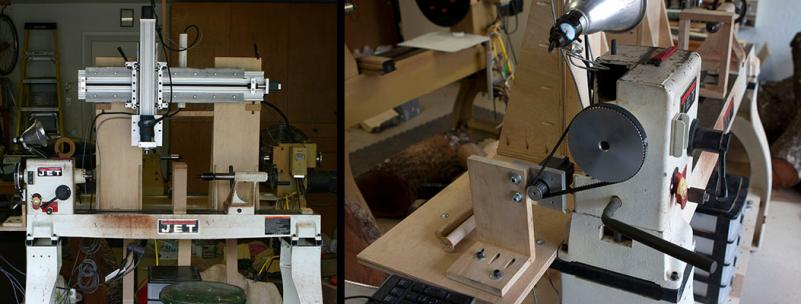

Morton - I built a digital ornamental lathe last year to add embellishments to my larger wood turnings. It can work on pieces up to 14" diameter and 25" long. Decided to try it out with some carving on pens. Kind of overkill for a pen, but it seems to work.
Bruce - Good catch. I was really anxious to see how this pen looked finished. I didn't want to clear cast it until the paint was completely dry. So, I had the bright idea of putting the painted core under vacuum to force dry it. It dried it really fast, but it bubbled up the paint. Even without the vacuum mishap, I don't think paint would ever look like real gold. I thought about gold leafing it, but the carved areas are so small I don't think it would be practical. My next thought is to use a two part metal reactive paint and build up the paint coats flush with the non-carved surface. When polished the two part metal paint looks like real metal (smooth and very shiny). I would have to use brass or copper though. Real gold isn't in the play budget.

I like it a lot. Must have been a really small cutter, I can't see much radius in the work. Huge run time? Very nice!
Hi low_48 - Job was done with a 30 degree engraving cutter with a 0.003" tip. Capable of a pretty good level of shallow detail (0.005" to 0.010" depth of cut depending on what I'm doing) without being so fragile it breaks if somebody in the neighborhood sneezes. It took about 40 minutes on the DOL (aka Digital Ornamental Lathe).

Hi Brian & Bob - I converted an old worn out Jet 1442 I had stashed in a corner of my shop (it was my first lathe). It's my own design, but I benefited from the experience and knowledge of a lot of people who shared theirs on various forums. Here's a picture.

Hi Brian - A really good place to start your research is cnczone. The forum index can be a bit intimidating, but way down the list you will find a forum on "Woodworking Machines" with a subforum on "DIY - CNC Router Table Machines". Reading some of the discussions and build logs is a good way to learn a lot fast.

In reading some of the comments back and forth, my 2 cents would be to not fill the craved out areas level with the black core. Having the depth and 3D adds a lot to the pen.

I agree that the gold looks a little rough but that is a problem with some woods. Now here is where your focus should be - matching the right bits with the right wood. That is the difference between getting smooth or rough cuts. I would suggest learning to stabilize the wood and then giving that a try. It will make it a little more like Plastic Resin and therefore probably cut smoother.
Not Directly related but kinda - A skew does better in making smooth turning on soft woods while a scraper generally does better on hard woods. The point for you - different blades and angles work differently on different woods.
Also, the rough cuts showing through on the Gold, is something that I have seen with people who use the Pen Mill, kind of like a larger and less sophisticated version of what your are using. Small rotating bits don't usually make good smooth cuts in wood overall. But the key is finding the right bit for the particular wood and doing a good job of stabilizing the wood first.
