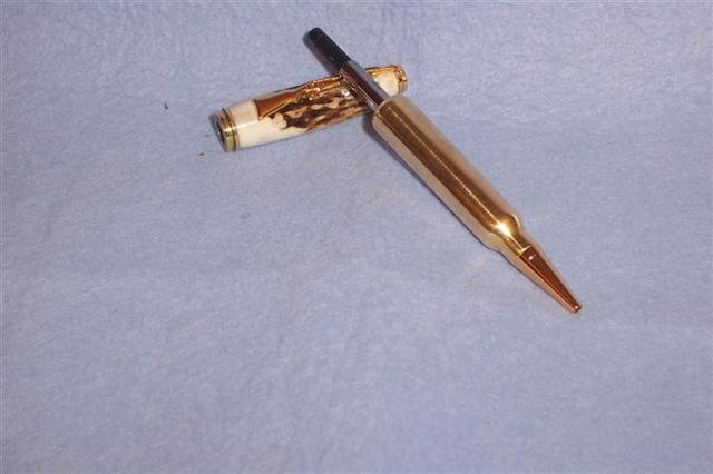

In turning antler where I am trying to get staghorn
<br />
I have found it easier to rough turn on the lathe and drill with a Beall collet on a lathe.The Steb or steb type center is invaluable for this.A regular chuck will tear up the antler if it catches.
For antler that is solid with no hope of stag horn I square them on the bandsaw and drill on the DP.
As far as finishes goes there is no debate.
I like the method I use.
That method is to realize each antler is unique and is is not possible to say THIS is the way to do it.
Some antler witll feel like marble after MM.
Some is so porus you need CA just to look at it.
There is some that is a combination of both or none of the above.
When one method doesn't give me the results I want I keep at it until I get the final results I Do.
Like I said there is no debate.
There is no one way to finish antler.
No 2 pieces of antler that I have turned and finished are exactly the same.
I like my steb steb type center for preparing antler.
Since I started using it on the pieces I used to to think were questionable as to whether they would be large enough for a paticular pen, I have had less blow outs, less drill holes through the sides and more interesting looking pens.
