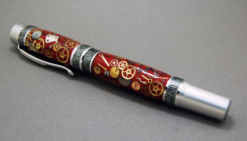

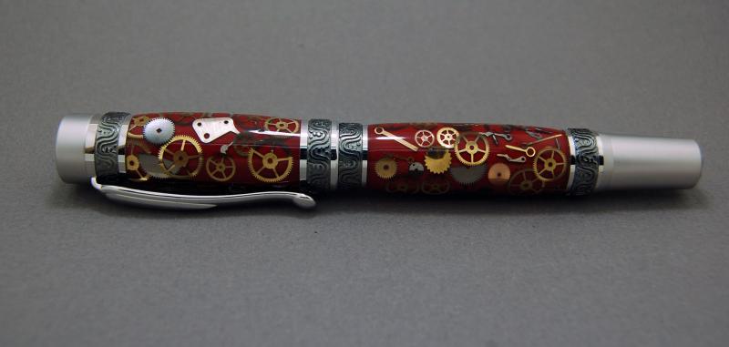

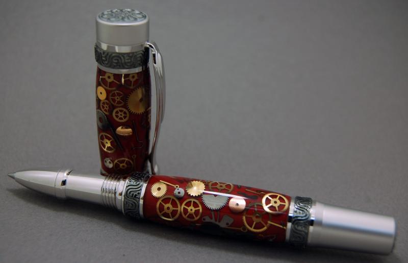

This is for my wife for Christmas, but I know none of you will ruin the surprise.
Tubes are painted red and cast in poly resin. I glued the pieces with epoxy, then cast it.
All comments are welcome. Be kind, it's Christmas.

The pen is very good. The fit and finish is outstanding. The photo gave me problems at first. In the assembled photo, there appears to be a scratch/crack running the entire length of the pen. Upon closer inspection, the scratch even continues across the CB, therefore not a scratch at all but a lighting artifact. Of course, we can still call it a crack. In that case, you surely would not want to give your wife something so obviously flawed. So to help you out with this problem, just pack it well and send it to me. I believe I can find a place to hide it so your problem will never be seen by your wife.:rolleyes::wink::eek::biggrin:

Did you paint the tubes and then epoxy the widgets directly onto the tubes? How thick is the PR? I tried this with the top part of a Euro / Designer (14mm OD, 7mm tube = 3.5mm radially thick PR) but I couldn't get the damn thing so the edges of the gears weren't sticking out the polyester after turning!

KDM: I did paint the tubes, then epoxied the pieces one at a time to them. I just smeared some epoxy on as much of the tube as I figured I could cover before the epoxy set and started putting the pieces on. With the gears and some of the other big pieces, I bent them first. The poly is very thin. In fact, that's why the pen is fatter in the middle than at the ends. I tend to like B to B profile, but in this case, if I had done that, I would have taken out some of the parts.
No doubt about it, though. I need to improve on my photography. :-) Here's one without the "crack".

Gorgeous! The amount of "stuff" (hope that isn't too technical of a term) looks just right. The Lotus seems like a too-busy kit, but you made it look like a great match.

I think the photos are great and especially the last one. What kind of paint did you use so as to not get runs and brush marks. I have tried using automotive paint but it dries so darn fast I can't get the entire tube painted. Also you said you smeared with epoxy, what kind of epoxy did you use that is crystal clear. I have never seen epopxy that clear drying. Thanks for showing and I am sure that will bring some $$$.
Oh one other question did you use a clock face that we don't see and if not why???

To JT: I just used Krylon spray. It's what I had in the shop. I sprayed a couple of light coats and let it dry for a day. No magic there. For epoxy, I used the System Three 5 minute stuff. I get it from Lee Valley. Again, it's what I had in the shop. I use it to glue in tubes for other pens. You can go to the systemthree.com site to see it. It dries completely clear. Finally, there is not watch face. Why? Because I didn't have one. I got the parts on Ebay and the package didn't have a face in it. :-) Oh, and this one won't bring any $$$. It's a Christmas present for my wife. (Now, of course, if she sells it ......)
