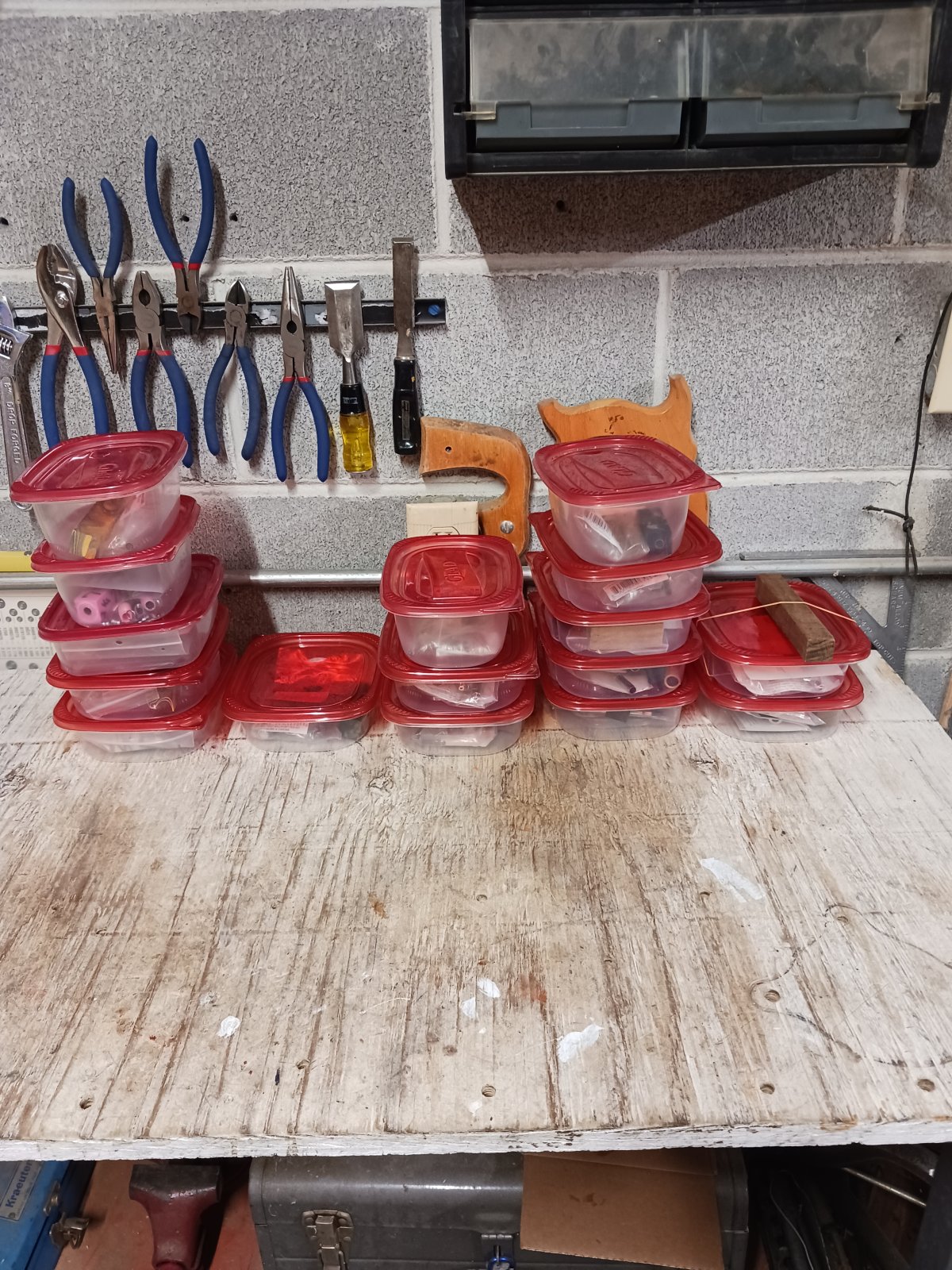

I separate the kits and put them in the deli meat boxes which I believe are Hillshire products. I include a sticky note with the drill bit size, blank and the folded instruction sheet if it's only one style. If doing several styles as Slimline, the instruction sheet is put on a clipboard and hung over the workbench.
I have small pencil boxes that hold a single kit & blank. They're numbered 1-24, and I also write the number, species, and kit on both halves of the blank in case something drops before I've started turning.

Similar to the above, I use trays. Mine are 3"x6"x2" and 3"x9"x2" acrylic drawer organizers. I put the kit, kit bag, blank cut offs, bushings etc in the tray until I'm done. At 2" deep they are reasonably stackable with the parts in in case I need to set them all aside for a bit. I also have a stack of takeout containers for larger jobs.
