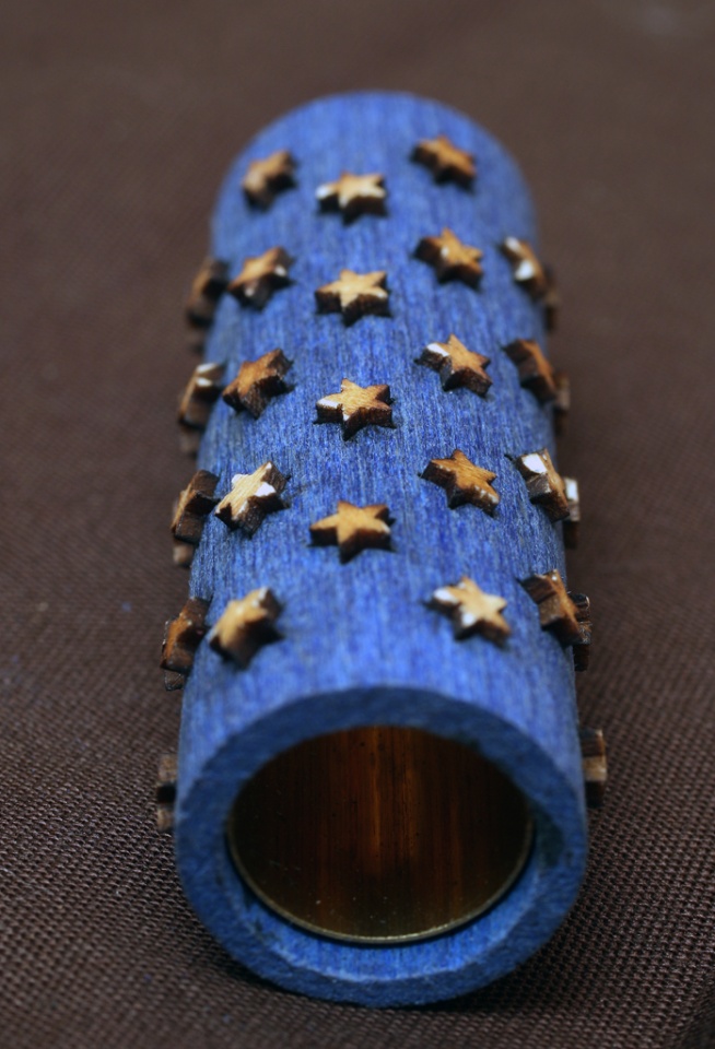

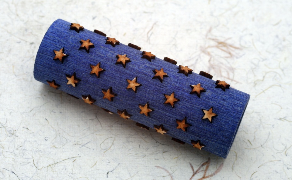

If you note how much material you need to take off then note how deep the cut out runs then you can quickly see how deep they need to be pushed in.
Don't bother with forcing them in but put all of them in then roll the tube and that will push them in evenly.
Ed's pics are the best. That's about how mine look once I've got them in as well. My first attempt was assembling dry and that didn't end well...
Dipping in water is all the lube I've needed.

Richard I dip them in a diluted soapy water, use the pointy exacto to stab them in. I will then use the body of the exacto to help 'roll' them in. They will stick out a bit per Ed's picture. Sharp tools and easy does it on these. I've made quite a few of these. NICE PENS!
