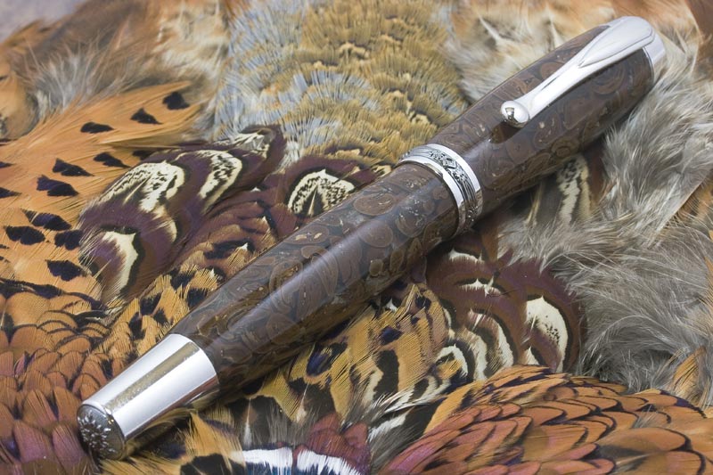

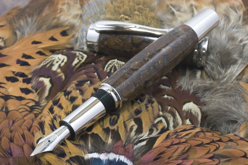

I made this one with Sturbucks beans. I'll deep it in hot water tomorrow and see if it works [:o)]

Can you give us some construction details.
Was this whole beans cast and then drilled?
Yes. Ifist cast the blank then turned drill and turn. The beans will float on the resin so I need to find a way to keep them from doing so; this cast was done in two halves because it was not thick enough the first time arround.
Painted the tube and the inside hole with brown, and turn. The finish is CA, BLO.

Could that be made in say a 3/4" PVC pipe, and have a cap placed on the end with a hole big enough to pour the resin, yet allow the resin to cure while cast under psi?? The caps could push the beans togather. You may need to turn the PVC off, but that's not a big deal, really.
How did you get it so that it looks like the beans are all underneath the outer part of the PR? I guess what I mean is how do you avoid having a big piece of bean on the outside of the pen? (Hope that makes sense, I'm not quite sure how to ask it...)
Originally posted by angboy
<br />How did you get it so that it looks like the beans are all underneath the outer part of the PR? I guess what I mean is how do you avoid having a big piece of bean on the outside of the pen? (Hope that makes sense, I'm not quite sure how to ask it...)
CA finish. Prior to it you would see the (piece outside) when you apply CA it blends with the PR and created the ilution of being burried underneath.
Funny thing, today someone at work asked me how did I packed the beans so thightly into a cartridge. That was kind an intersting question.
Hopes this helps
Alex
