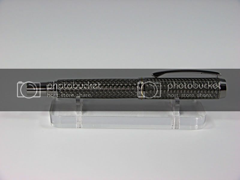

Finally finished this one yesterday for a customer. He wanted a stainless steel braiding on a Jr. Gent kit. I am not sure this would have been my best choice but the customer gets what they want. I chose a Rhodium kit. This is the one where I posted my rant about the plating on the kit being too thick and it cracked the the end when I pressed the parts on. After recasting and after using Jeff's (workingforwood) suggestions of disaasembly I was able to save the kit and do the necessary fixes to make it work. Here it is and thanks for looking. As always any questions or comments are always welcomed.

This is from Home Depot's plumbing dept. It actually is flexible plumber's pipeing the kind they use to hook up sinks and toilets with.:smile: The reason I like this stuff so much is because it is already coated with some sort of epoxy to give it a high finished shine, so when I cast it I don't have to worry about oils contaminating the casting which you can get from metals. You can get the products you talk about and some come in different colors too. Just too expensive for me. This is a whole lot cheaper. Get a 3 foot piece and you can get many pens out of it.

I really like this. I guess now I have to buy molds and learn how to cast to make myself one. Do you have to remove the rubber tube from the supply hose? If so how do you keep the braid and cover intact? I mean if it's not your trade secret?

First let me say thanks for all the kind words and to Jeff for help in saving this not so cheap kit:smile: I hate to lose kits to the spare parts bins. Have enough of those when I first started learning this stuff:smile:
As far as the tubing goes. Cut the ends off with a hacksaw and the rubber tubbing slides right out very easily as long as you keep pushing it closed. Think Chinese fingers with this stuff. What is so nice with this stuff is the coating that is on there and the weaving does not unravel easily. I have done the brass also if you all remember my 4 metals castings. The brass is abit too yellow looking though and that maybe because of the coating but it sells also. The hardest part of making these is not the casting but the trimming to true up the ends.

I've been trying to do a simular thing with Coaxle cable. Just couldnt get it to work, always ruined the braid trying to fit it on the tube. Will have to try with the flex pipe.
