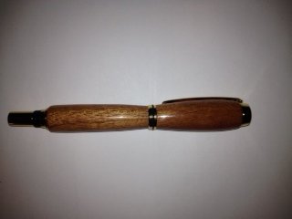

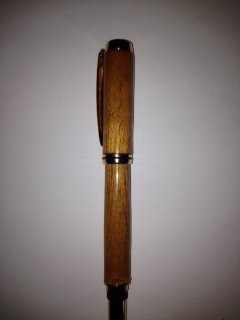

I finished the first blanks yesterday, 3 hours after turning. I just finished the second set but use tack clothe just prior to finishing. The second ones have more grain "pop" even after sitting out over night. Thanks for the idea of the tack clothe, I had one but hadn't used in a while. The pictures are from iphone adn don't show as much difference as really exists.
