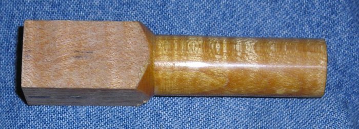

This is a piece of stabilized maple, but without the shellac.
