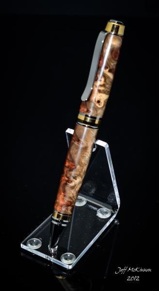

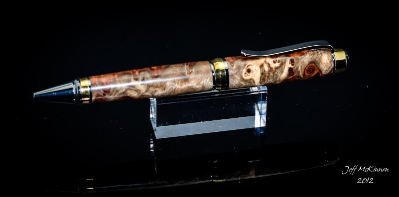

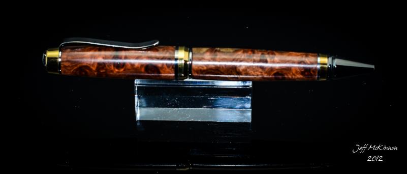

Here is a pen I did out of some Amboyna that I stabilized with cactus juice. Just sanded and polished. Absolutely "0" finish, wax, CA.....

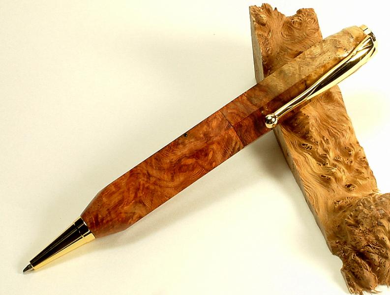

Enclosed pic of a pen finished this week using Amboyna sourced in the USA.
