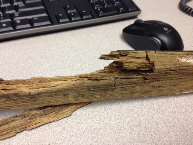

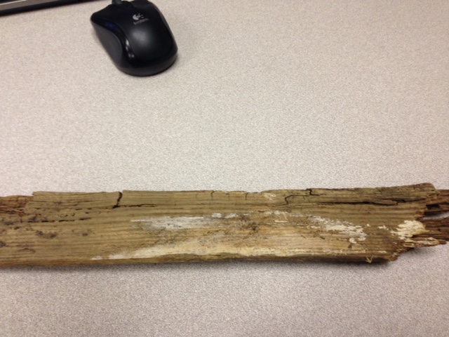

Good afternoon everyone,
I have a coworker who has asked me to make a pen out of an old piece of furniture wood that has some sentimental value to her husband. She brought me the piece of wood today and it is very brittle and will not likely survive a turn on the lathe.
What would it cost to stabilize and would anyone have some time to do it for me?
I won't be able to get it to your for a week or two as I won't be back at my workshop to rip it down to size for a little bit.
thanks in advance!
-adam

Well, Adam has mentioned that, the wood to treat was part of a piece of furniture, and with my experience in furniture making and restoration, I wouldn't be surprised if the wood is saturated/impregnated with one or various chemicals and oils used to make furniture finishes in the old days.
Oils, would be your first concern, and if the wood is "contaminated" with anything that can compromise the stabilizing solution performance, the results can be far from satisfactory, indeed...!
What I'm trying to say here is, very kind of you to offer to help, I would offer to do them myself if no one would come forwards HOWEVER, I wouldn't make a statement like that, even before I had the opportunity to see what I was working with.
There are so many factors/things that can jeopardize a good stabilization process, some of which may be beyond our control, old, used woods, can offer a number of challenges that, you have to account for...!
Saying all this, I hope that at least my observation can bring your attention to these possibilities and make you more careful with the way you are going to handle this wood, in any case, I wish you the best of luck...!:wink::biggrin:

Adam & George - These are issues that could interfere with any attemp to stabilize the wood. If/when I here from Adam, I'll go over this, and other points, to set reasonable expectations. It seems prudent to use a small piece as a test example before stabilizing the rest.

I don't know your level of experience in regards to dealing with "used" woods and even if I knew, I'm sure that I would have brought your attention to the possibilities, and at the same time, allow others interested in stabilizing or that never handled nothing else but, fairly fresh and uncontaminated woods, I have less worries in stabilizing 5,000 years bogwood than I have with woods that once were part of old furniture, not all are oil contaminate but some are and really bad...!
So, my comments were more directed to the possible contamination issues than anything else...!

When I met with the customer yesterday I did explain the stabilization process and that it is not always successful, particularly with old and brittle wood. She did still want me to give it a try and see if it will work. So while i'm hopeful that it will work, I also realize that it might not work.
