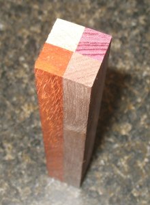

I glued up some blanks made of 4 woods, one of them being Walnut which is much softer than the other woods. Turns out when you drill it, the bit go off-center toward the softer Walnut. Yes...my bits are sharp. I'm drilling on my lathe, upping the speed helps, but it does not eliminate the problem completely. I'm hoping that stabilization will get the Walnut closer in hardness to the other woods and eliminate the problem.

Another thing you could try, if you have more wood and time for another glue-up, is to cut a small chamfer on one corner of each blank, and glue them up with the 4 chamfers towards the center. With careful gluing and clamping, you'll end up with a 'pilot hole' down the middle that will have glue squeeze out only in it. That might help with drilling issues.

I don't think it will work because there is still nothing to keep the bit from pushing away from the harder woods towards the Walnut. I may give it a try though. Thanks.

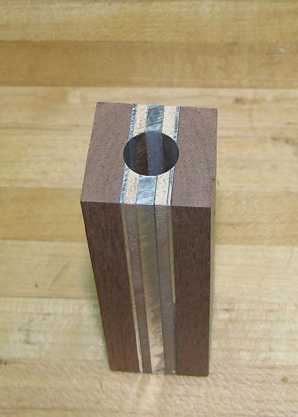

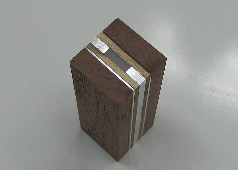

Timothy I had a not too dissembler problem with a wood and metal glue up. This won't help with your current blanks but you might try it with any future ones.
In my problem the I was drilling down the center end of a 1/8" piece of aluminum sandwiched between pieces of wood. Essentially splitting the aluminum into two separate strips separated by a 7mm hole. The drill bit wanted to e "walk off" the 1/8" wide aluminum into the much softer wood. I solved the problem by "pre-splitting" the aluminum. The two pieces of aluminum are separated by a distance approximating the diameter of the bit. I just glued int a scrap piece of UHMW as a separator. It was much softer then either the wood or the aluminum. Here is the result.
In your case you you could glue in a piece of soft pine or similar wood. Just rabbit or chamfer each piece to accept the softer wood. I would think this would work better then a chamfer alone because the variation in glue squeeze-out would be eliminated.
