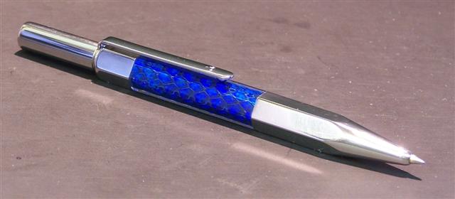

SS SS SL Snake.....Six Sided Stainless Steel Slimline Snake. ;)
It's almost my first IAP birthday:D so I thought I'd make one for myself this time. [8D] The flats on the steel were done using a bench grinder and the flats on the blue cast cobra was done with a router. Still needs a bit more polising, but I have blisters already!:D
S S S S S Simply amazing. Creative craftsmanship all the way. I certainly approve of this one.
-Peter-[:)]

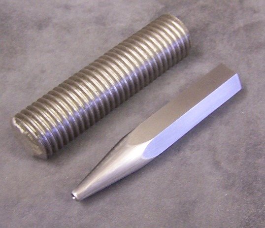

The steel was cut using a small bench grinder on my compound table on my wood lathe. Each pass was so light that it did not get hot. Took forever as the grinder is so small it kept stalling. The even sides were done using the index ring on the chuck.
Thanks again

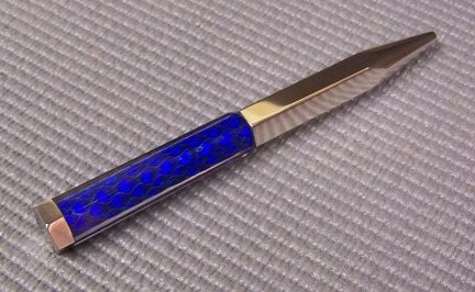

I didn't like the fact that I had sharp corners when I twisted the pen.
Here's the nib before I cut it shorter for the second attempt
<br />
