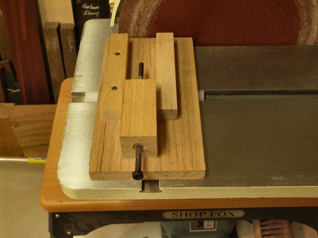

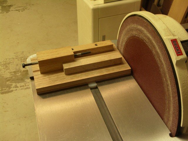

I use often my disc-sander, with the miter gauge that came with it and a squaring jig I made from a squared piece of wood with an "A" and a "B" mandrel piece installed on each side! This is pretty square for me...since the squared piece of wood with the squared mandrel pieces are squared against the squared miter gauge (with I square using a 100% true square)...
Here are pics of the jig I use to square pen blanks on my disc sander. I got the idea from the Yahoo Penturners Group. There are more pics of it in the How-to-Section there, in the file labeled "Jigs".
<br />
<br />
<br />
I tried a jig like Gary’s. One suggestion cut off the threads on the bolt. After getting the jig going good I have switched to a PSI trimmer in a drill press. I tend to cut my blanks long (especially if I am cutting nasty stuff like antler) and if you keep a bright light on the blank while you trim the tube will shine when you touch it.
My method of squaring the ends of blanks: disk sander and a squaring jig....one jig for all pens...made from free scrap....cheaper than buying the pilot for each tube size. I actually find the disk sander faster, easier and just (if not more) as accurate as the penmill.
