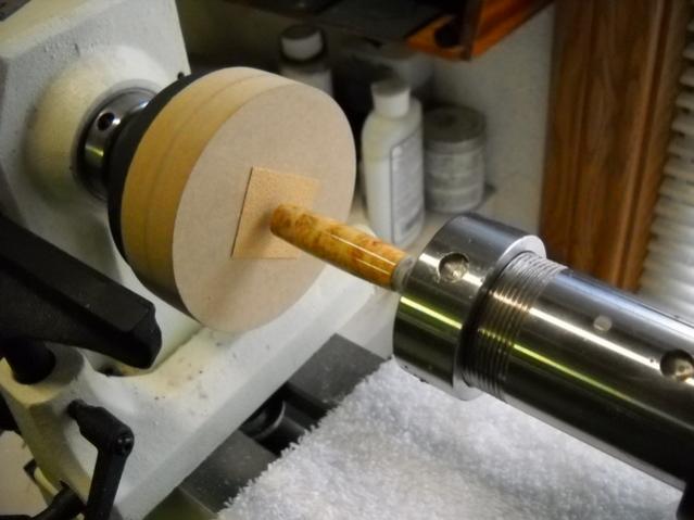

Like others have mentioned, I trim most with disc sander and the last bits with pen so mill stays sharp for more pens. I do use this setup sometimes for expensive blanks and to take CA off the ends of barrels (pen mandrel in tailstock/collet chuck and Delrin pen mill sleeves to keep blank square):
